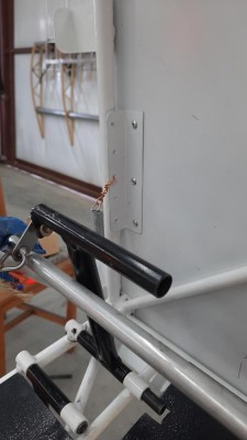

The bar positions the rudder Pedal in the neutral position as is the rudder also clamped in the neutral position for setting the control cable length. The L-angle is pop-riveted to the firewall and allows 5 locations for attaching the rudder and brake return springs.
