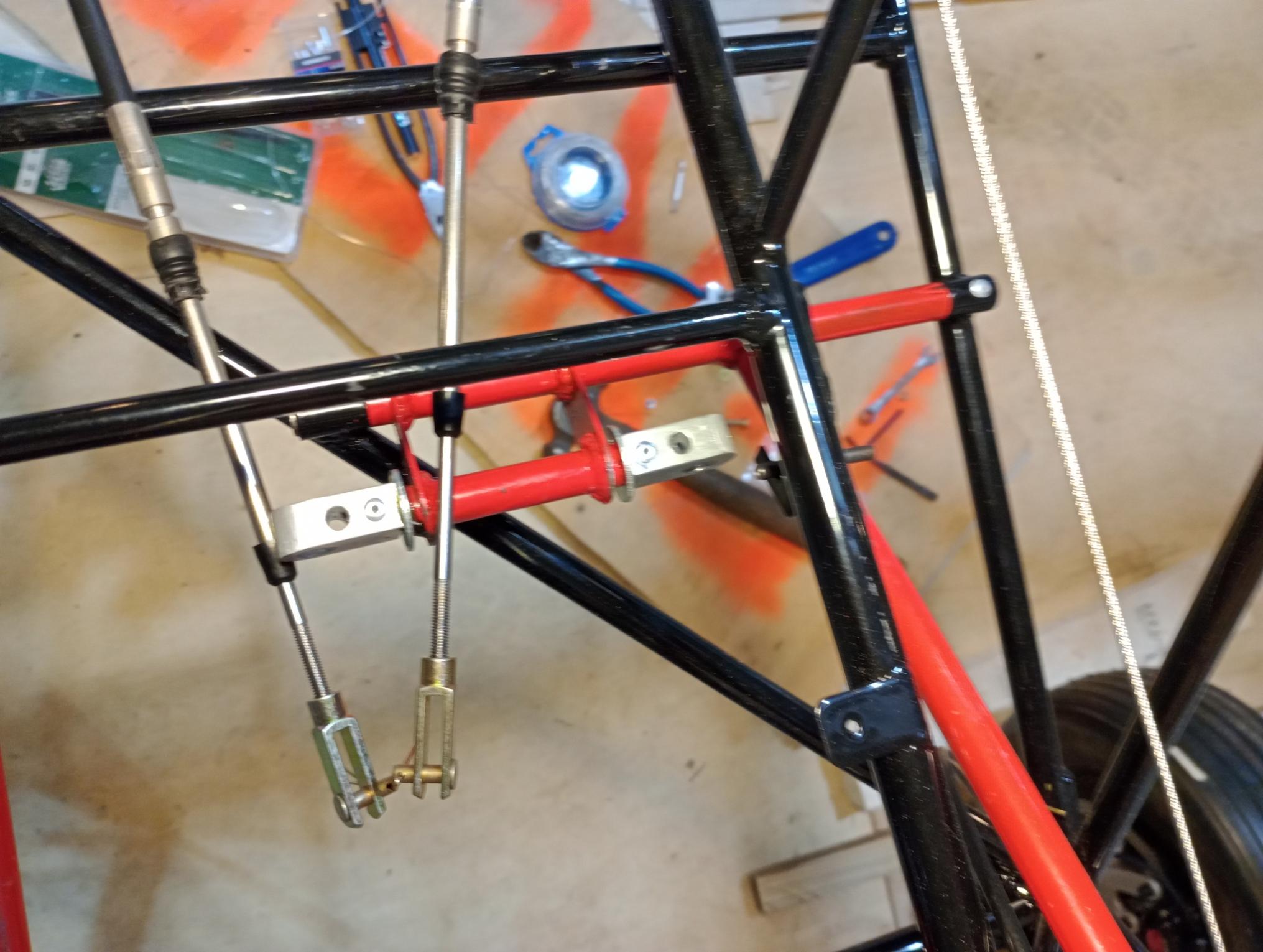

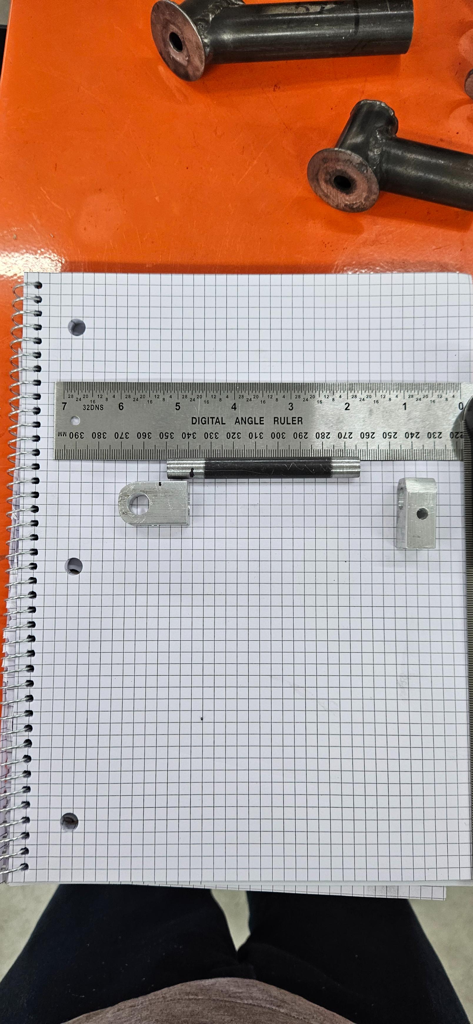

I have downloaded pictures of the Flaperon control pivot which is different from the one in the manual. In the manual it shows the flaperon cables being held in place with a lock nut on either side of the pivot. On the updated version I do not have threads on the cable for a lock nut nor do I have lock nuts provided. Any thoughts? I also sent a pic of the parts for the throttle. The center hole is larger possibly for a bushing but the throttle is completely different from the one in the manual. Anyone else run into this?
CraigDowning
Posts: 18
Joined: Thu Jan 19, 2023 1:48 pm
Re: Help in assembly
Post by CraigDowning »
throttle
throttle
Flaperon Pivot
Flaperon Pivot
flaperon pivot
flaperon pivot
Does the end of the cable housing unthread, back where the smooth pieces of aluminum are? Here is a pic of mine. For yours it looks like the bracket should sit in the "indented" portion of the cable housing.
I would see if you can unthread the end of the cable sheathing behind the rubber boot. Otherwise, perhaps there are meant to be snap rings to hold it in place?
Odd - my pic isn't uploading. Stand by as I try to sort this out.
As for the throttle, it looks like the round knurled knob is the grip itself. The triangular piece is the pivot point and should allow you to lock or tension the throttle. Do any of the bolts fit snuggly through the center hole? Or does the triangular piece have a thinner part that fits into the hole like a sleeve?

Sorry for not attached the update Craig. Pretty straight forward. The pinned bulkhead cable replaces the threaded bulkhead. An3 bolts secure it in place.

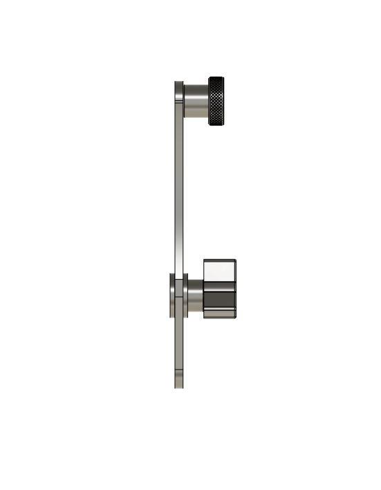

Throttle is new and more simple. I like a bend at the top.
Throttle CAD.JPG (8.63 KiB) Viewed 59455 times
