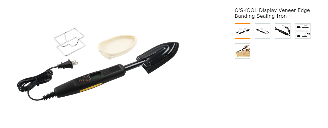

Another useful tool for covering. (more model airplane stuff)
Some even have a Teflon coating and slide real easy.
Its basically a small iron.
The pricey ones have a digital temp display.

Its able to apply heat directly over a single wrinkle and flatten it out. Some even have a Teflon coating and slide real easy.

I have one too. Very helpful for those hard to get to wraps around the tubing in the cockpit area. Order an extra cloth cover. The Sentinel heat gun is my most used tool. Good temperature control, 3 fan speeds. Also, as I posted, I purchased the curved nozzle for getting around the tubing. I also have theToko flat iron, but have not used it as yet, probably will when I cover the big open areas of the wings.
