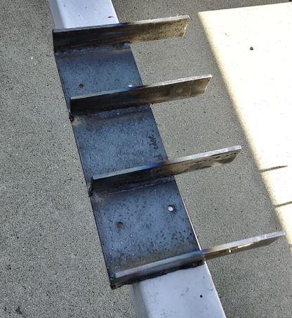

After my "incident" a few weeks ago (getting stuck holding the tail of the plane high in the air while yelling for my wife to come rescue me), I decided to go in a different direction with the tail support.
I ended up buying a scissor jack with a 24" lift as well as a small plate of mild steel (4"x1/8"x24"). The intent is to winch the plane all the way up until the tail spring is over the scissor jack, then lift it mechanically. I'm sure my back and my neck (which is still sore) will thank me.
I had to reconcile where to mount the scissor jack so it doesn't interfere with the tail of the plane. As a result the initial plan to keep it simple and mount the jack on top of the rear crossmember had to be rejected.
After some consideration I decided to add a plate just ahead of the crossmember, and supported from underneath so as not to interfere with the jack base.
This is what I came up with.
I welded it into place (again not doing my neck any favors when welding the underside.
It had been predrilled for the jack, and was test fit multiple times to make sure the welds don't interfere with the base, possibly misaligning the bolt holes.

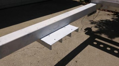

Once the welding was done I threw a coat of primer on it.

Looks great man, nice job and great work around. There's always a way! Looking forward to seeing how it works once completed.

Thanks Todd. Here is the completed look.

I just read through this thread and noticed many apologies for amateur welding. I feel at least marginally qualified to say the welding on this project is just fine. Could it be better? Sure. Many of my welds could be better too, but what you have here is perfectly acceptable for the strength needed so don't beat yourself up. Also, don't be afraid to scrap a piece that you're not happy with and try again. The lost cost of the materials is nothing compared to the consequence of having the part fail while using it. Your peace of mind knowing it's done well is worth something too.
