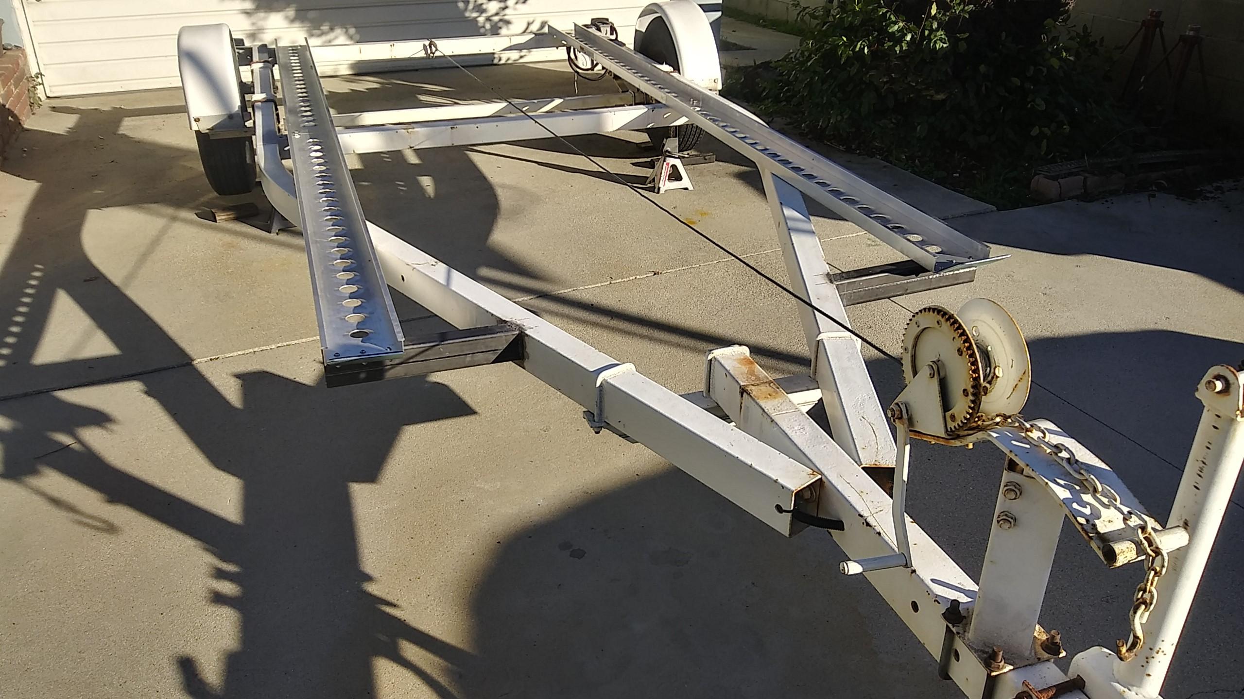

A little more progress has been made on the trailer. I got home to find a nice package of goodies for me.
I grabbed my work light (damned short winter days...I get to work and it's dark, I get home FROM work...and it's dark) and installed the bits and pieces.
I'm very happy to have made a bit more progress. I'm also glad I decided to replace the U-bolts; when removing one of the nuts I ended up shearing the bolt clean off.

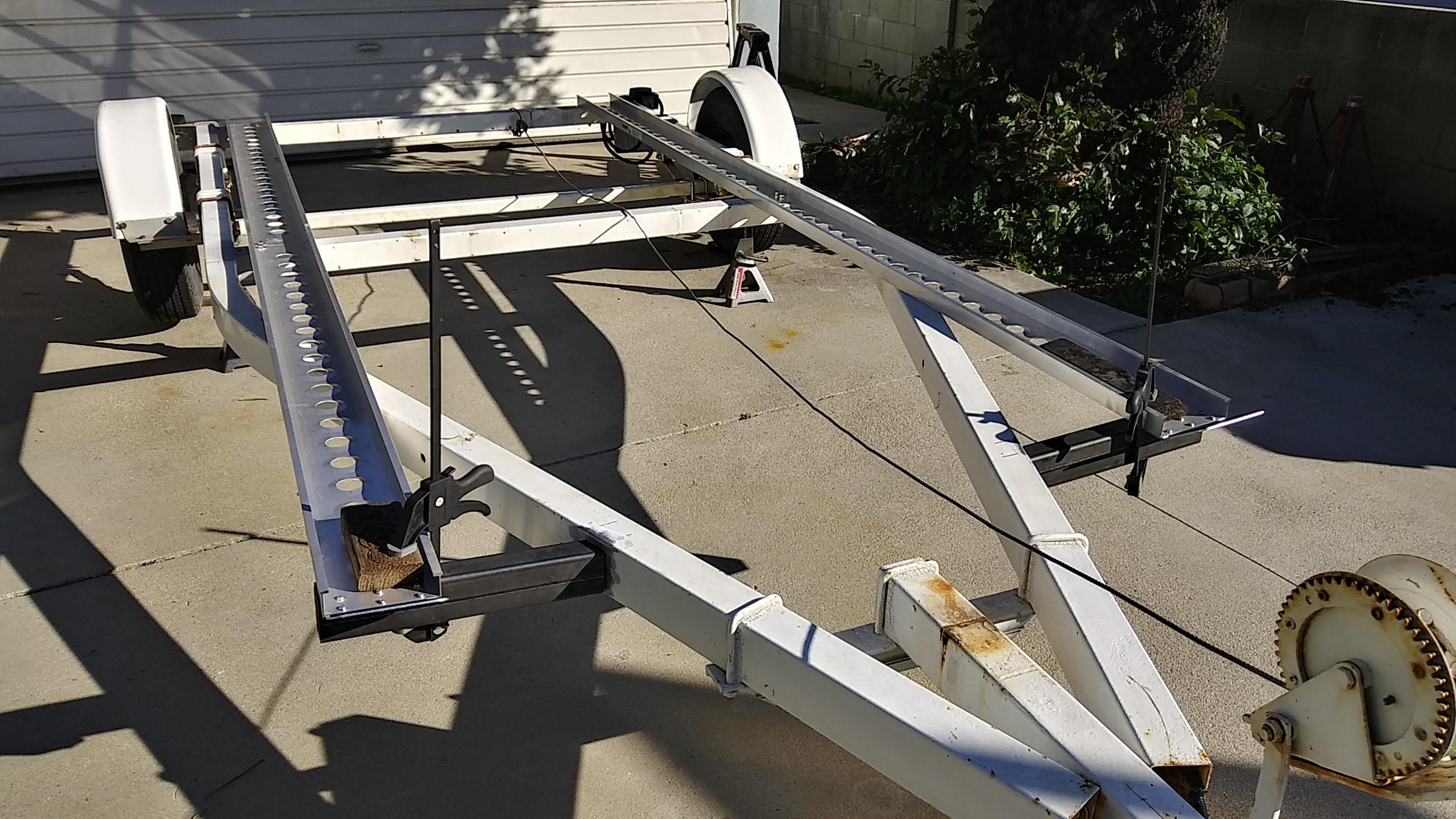

Well, I was able to make a bit more progress over my lunch break. I managed to mock up the ramp brackets and eyeball them to where they leave enough metal on the outer edge to support the lip of the ramp and still look decent. It was a compromise, as they aren't perfect, but they will work for sure.
I pulled out the welder and got them halfway welded in, more so I could remove the clamps and start putting things away than to get it done. I still have two sides to weld on both brackets. But...one step closer!

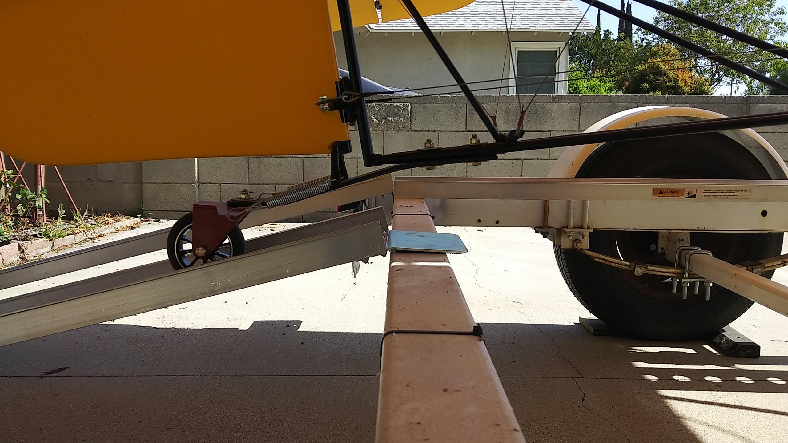

The next step was to make the bracket for the tail support. I may have mentioned my intent here - to have a hinged support that can be laid under the plane while the tail is still on the ground, and strapped to just under the tail wheel spring. When lifting the plane, the bracket will hang and I'll have to guide it to sit over the rear crossmember of the trailer. I had enough time to work on a proof of concept, and this is what I came up with using whatever scrap metal I had left in the garage. The curved lower pieces were made by cutting the end of a steel tube into quarters and welding it to the flat plates.
It seems to work well, and drops right into place. Of course it may be a bit more difficult when I am holding the tail of the plane up but I have a feeling it should work fine. This is what it looks like in place.

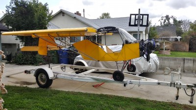

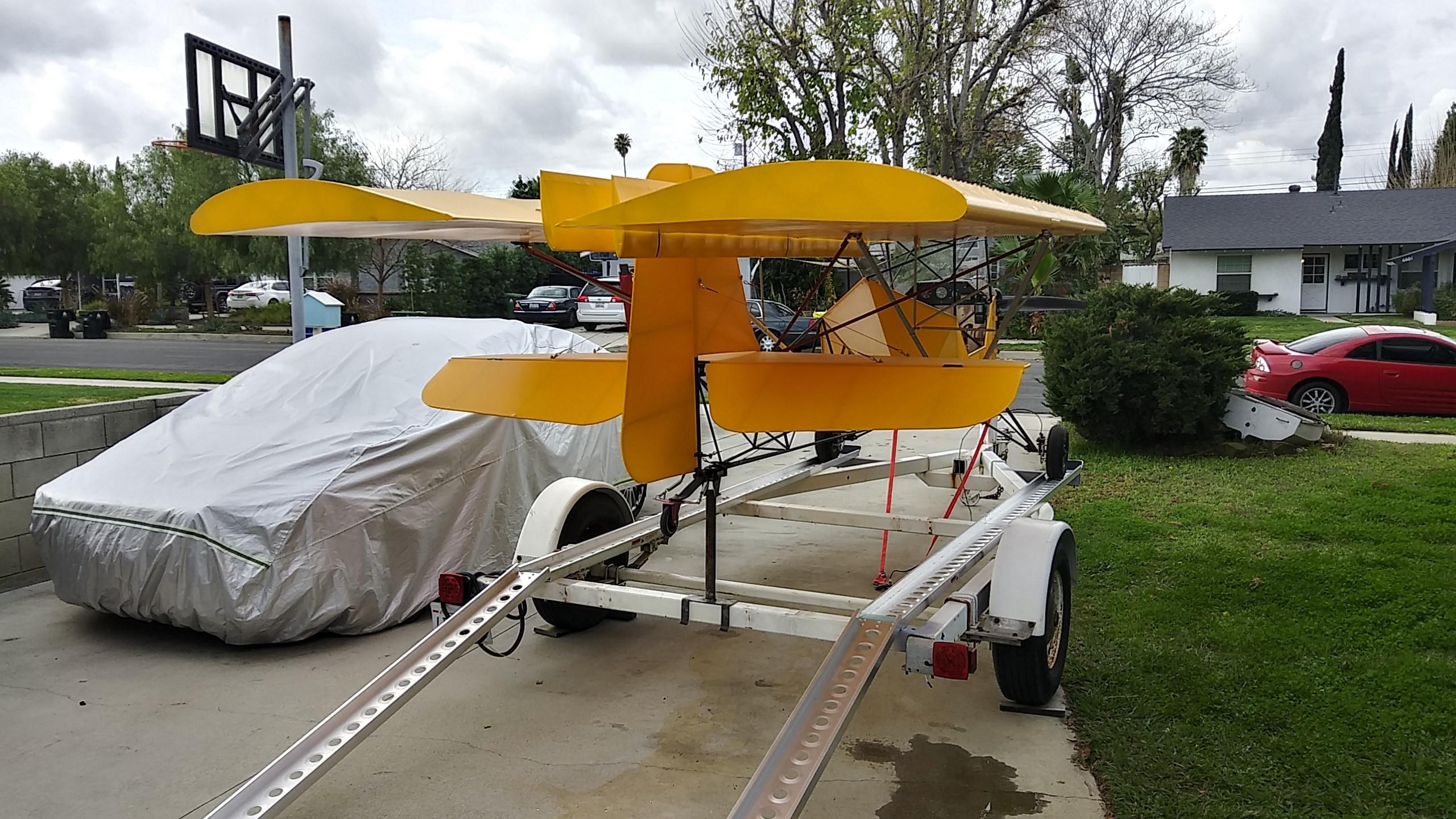

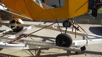

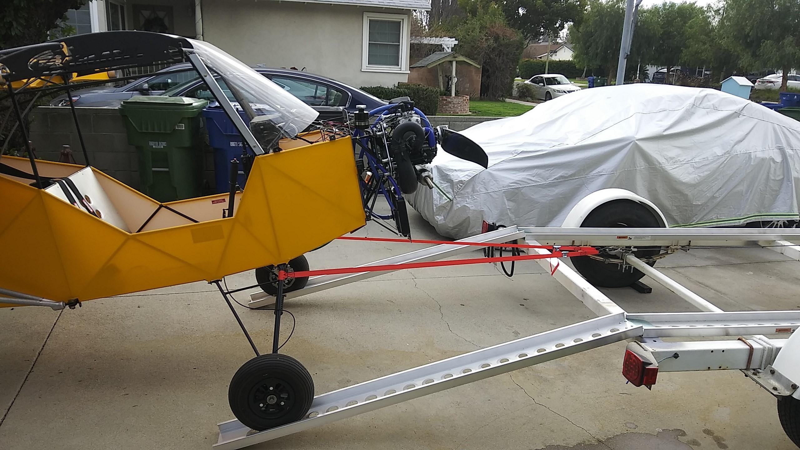

A quick update - the welding of the tail support has been completed, and I managed to have a clear day here (so far) and was able to test loading the plane on the trailer. It rolls up the ramps nicely using the existing boat winch.
Once I had the plane winched all the way up and pushed it forward until the underside of the fuselage contacted the rear crossmember of the trailer, I attached the new support using two velcro straps. I'll still need to pad the cradle on the support so I don't scratch the paint on the plane.
Once the bracket was Velcroed in place, I lifted the plane by the ends of the wings and walked it forward until the bracket was over the crossmember. I lowered it and it slipped into place nicely. This part was my biggest concern with this method of loading.
It sits nicely. The next step is to weld some D-rings onto the trailer for the tie-downs. Two will crisscross going forward from the main gear, two more will criss-cross going rearward from the main gear, and two more will go to each side of the grab handle just fore the vertical stabilizer.
Please voice any thoughts or concerns! Feedback is always appreciated before I go too deep down the rabbit hole.

That is really nice. I like how level the plane is. Nice work.
Re: F-3 Trailer Build
Thanks guys! I feel like it's coming along nicely. After lifting the rear of the plane manually, I think I may want to reinforce that tail support a bit, but overall I think it will work out fine!

A strong tail support is a must for trailering. The tail is pretty heavy with the wings folded. And the longerons will not carry the load without bending.
Allen, are you suggesting that the rear mount should be further forward, or is it good under the tail spring?
Mountain Cat
Posts: 213
Joined: Fri Mar 17, 2023 5:15 pm
Post by Mountain Cat »
Looks like you have it in the correct place. The longerons will not carry the weight! Nor will the tail spring by itself. Where you have it is excellent.
Gotcha. I responded pre-morning coffee and misunderstood. I think it will work out well for now but lifting the tail is obviously not the easiest option. I may experiment with a scissor jack down the road.

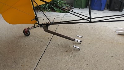

Hi. I am trying to include a couple of photos of my Badland on a trailer as Chris (of Badland) loaded ,secured and hauled it to Truman from S. Dakota. This plane has made this trip several times on this trailer and then to my place 2 hr north when I bought it. At this point it has been trailer much more than it has been flown, but I hope to change that this summer. Of note are the tail feather clamps made from two pieces of padded wood boards fastened at each end with a bolt and wing nut to prevent movement of the stabilizer and rudder. Also the wood block under the tail wheel attach point. One time - it was hauled without the block and the carbon fiber leaf sprig broke. It received some “trailer rash” from that and the spring was replaced with steel and it is always supported at the attachment point since then, even when just in storage in the hanger (garage). When I tailed it home from Chris’ place in Truman it had snowed and the roads where a little sloppy so we taped every opening and covered the engine cowl and open cabin with blankets and then I washed the whole plane with lots of fresh water once in the garage and let it air dry. A enclosed trailer would be ideal but the trailer I had available was not wide enough at the rear door without taking the flaperons off. Hope fully the photos show up and are helpful to some one that is needing to trailer their Badland. GaryR
Thanks for this Gary! These pics are helpful. I am probably going a bit overkill with my transporting method, but part of the reason is the limited space I have here in LA to store the trailer (meaning in my driveway).
Since my trailer is shorter than the fuselage, I figured the bracket was a good way to overcome that.
I'll have gust locks (control surface locks? Not sure of the proper term.) for my plane as well. I intend to make them from 1/2" PVC and the skinny pool noodles. (The 1/2" fits snuggly inside the pool noodles, so it should be ideal.
Out of curiosity, where did you get your carbon fiber tail spring? Was it from the fellow that makes various CF parts for the Minimax? I recall checking it out on his website.

Hi Peer. In regard to the carbon fiber tailwheel spring, it was an upgrade option from Badland on the f-4.
This plane was built in Las Vegas before Badland moved to Minnesota. If I got the story right from Chris it was just before your kit. or right after yours and it went to a customer in S.Dakota. That is when the carbon fiber spring failed and I don’t think Chris recommends it any more. He has a new tailwheel option that looks ready good that I am going to consider as I feel the current one is too small and should sit up a little more.
Best of luck with your trailer build. It looks really good, as does your plane. Especially with that engine upgrade!

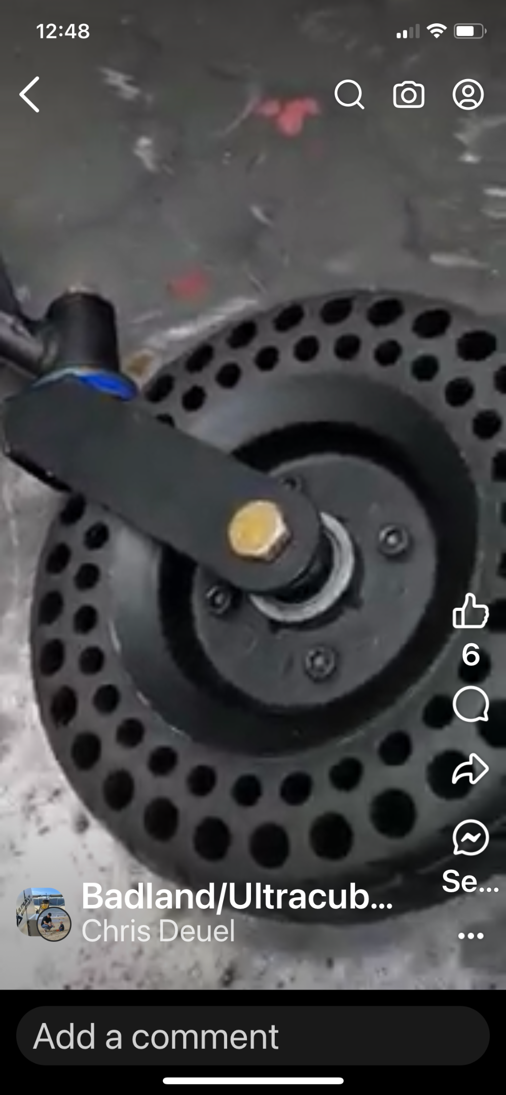

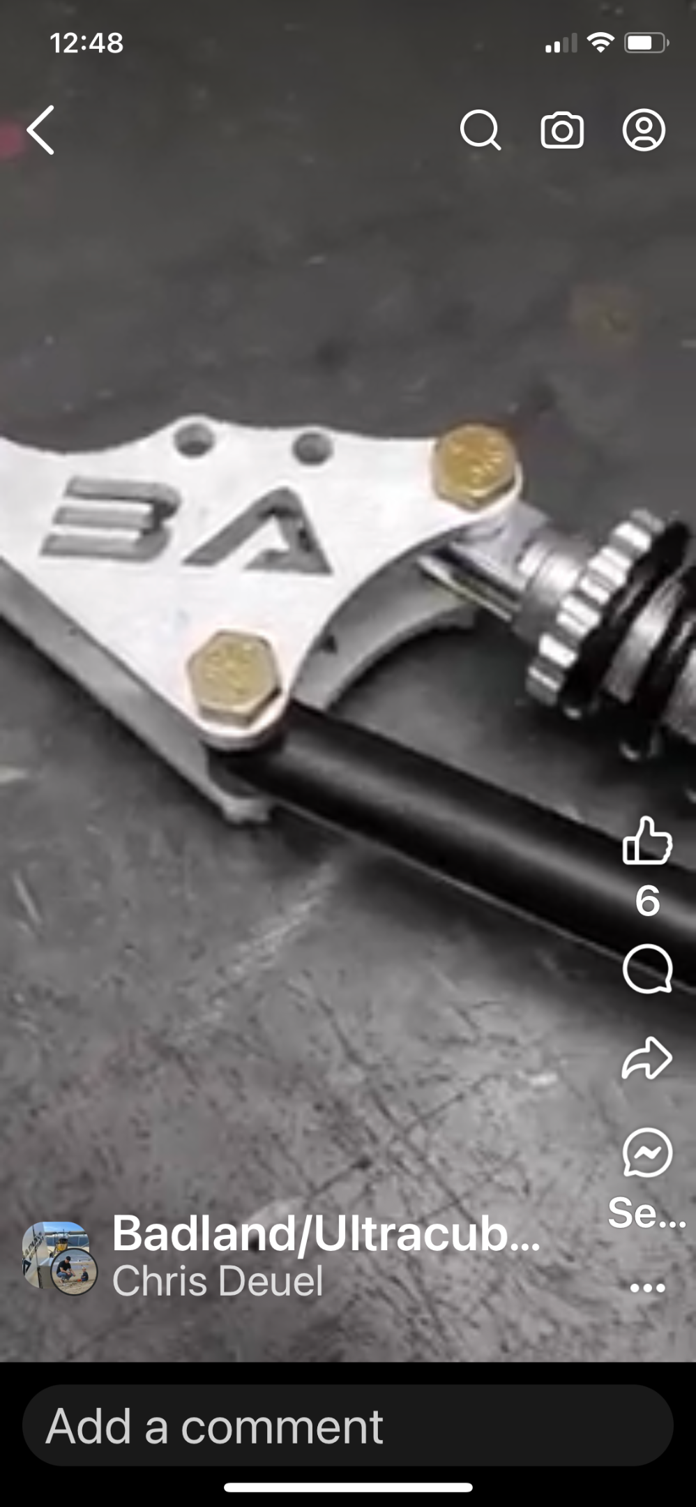

Maybe off topic of trailer build ,but I found the pic of Chris’ latest (I think) tailwheel which I really liked. Maybe looks too heavy but my bird is a little fat anyway. Chris advised learning to land on the one I have because it’s smallness and shortness could save the day from a ground loop on the grass runway
Looks pretty stout... translation: heavy.
I would be curious to know what it weighs compared to mine. I believe mine is a section of leaf spring, and it was pretty darned heavy as I recall!

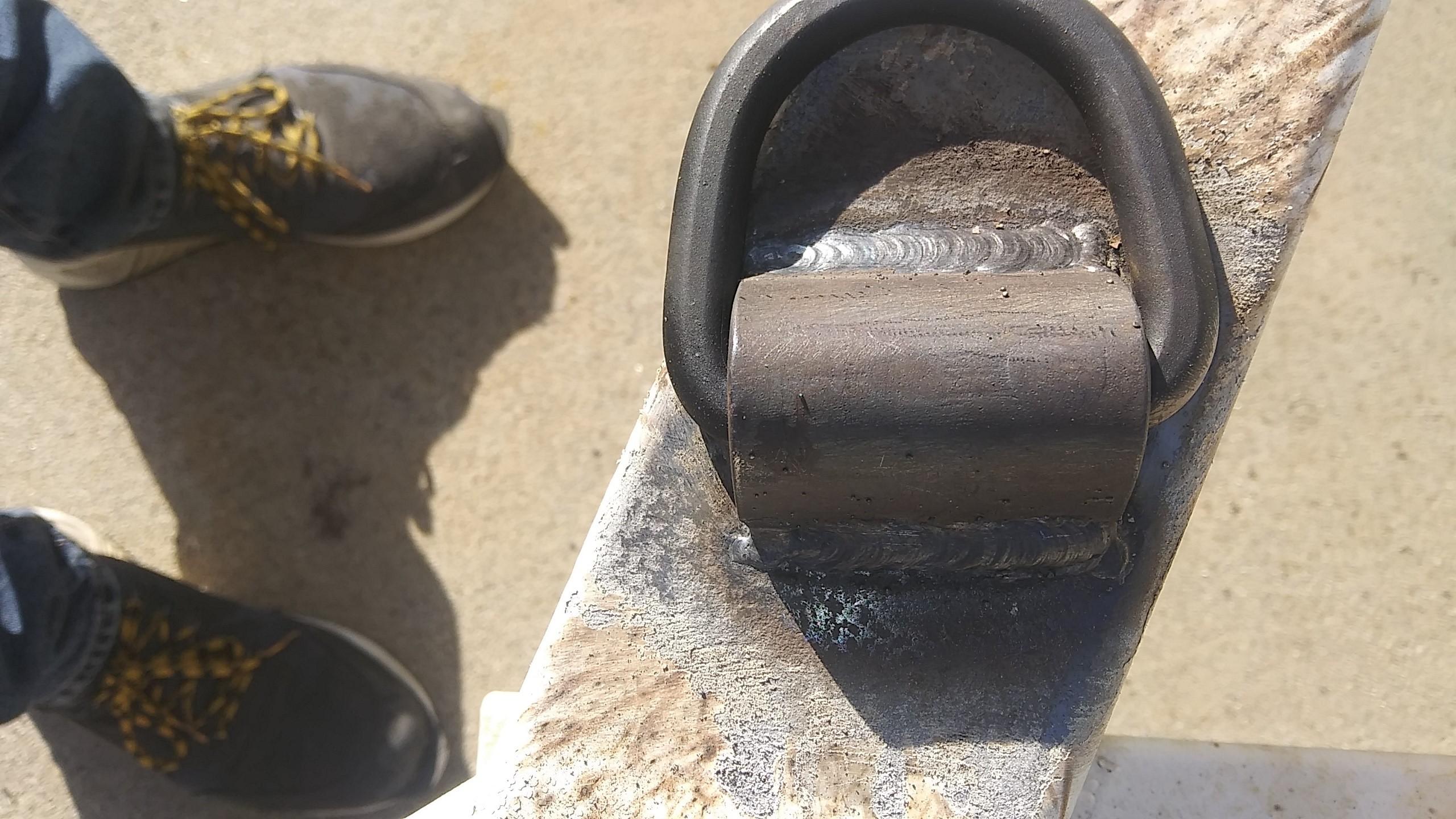

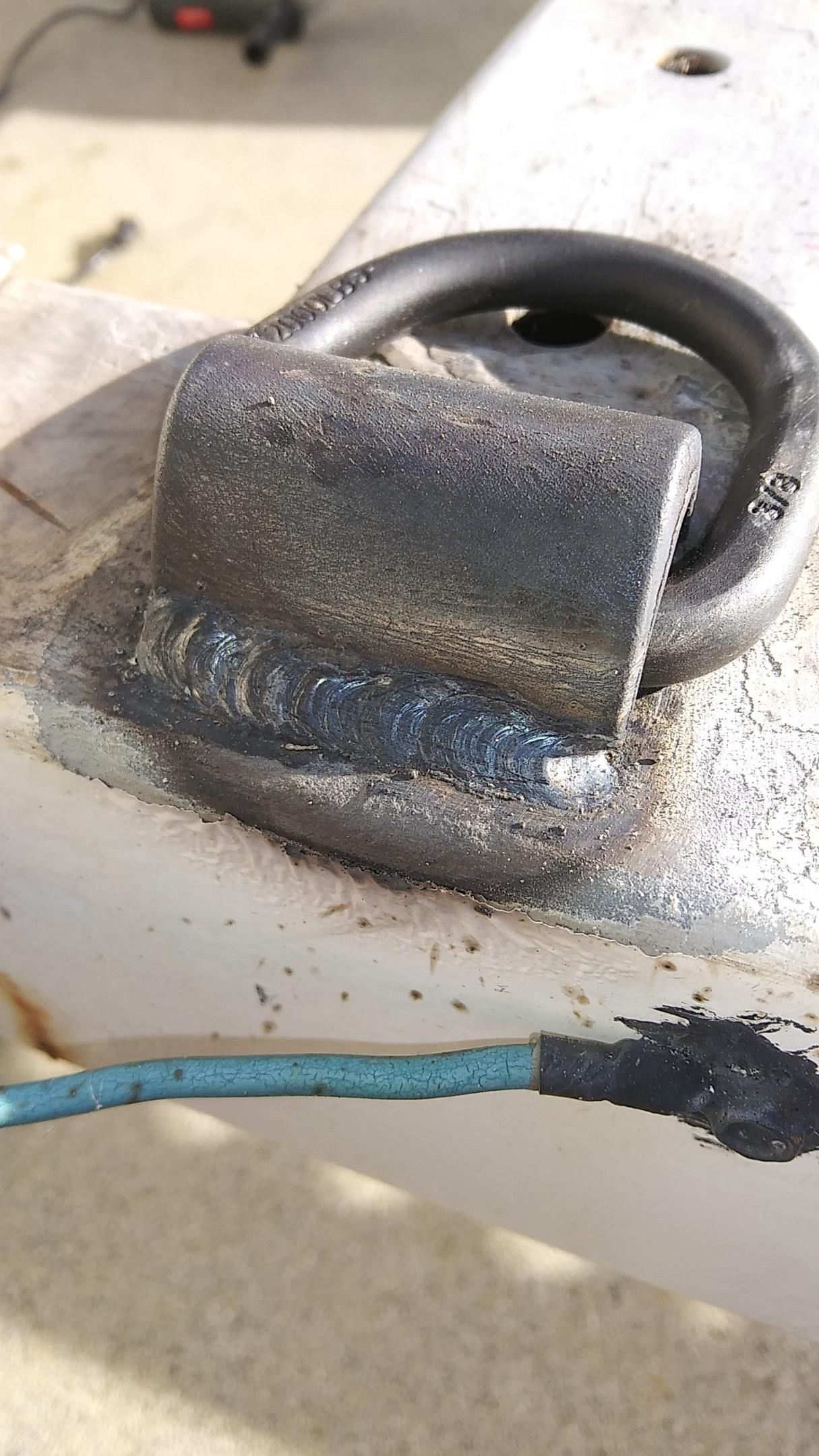

A bit more progress has been made to my trailer. I received my 3/8" D-rings for the tie-downs, so I once again loaded the plane onto the trailer and determined where the rings need to be welded on. I got the first four welded, and will likely end up with about ten total. In the process, I feel like my welding is improving, which is good. Any thoughts on that? Does the penetration and heat look about right?
As for the strapping down of the plane, does the marked location (thin red lined arrow) seem like a good place to put a ratchet strap? For the nose I will be going from the main gear forward and aft. I intend to do the same with the rear. So I may end up with eight straps total, but I prefer redundancy.

Welds look good! Remember you're not hauling a D-9 dozer.
Mountain Cat wrote: Mon Feb 26, 2024 6:36 pm Welds look good! Remember you're not hauling a D-9 dozer.
Thanks! And very true...but you never know when you might NEED to!
Posts: 823
Agreed, those welds look really nice. Be careful, Chris may hire you in Minnesota to help with Badland production! :lol:
Really, though, the project is looking great.
Todd, if Chris offered, I might just take him up on it! I have to say, welding is a lot of fun...once you get to be at least halfway decent at it, which is where I feel like I am at.
I completed the welding of the tie down D-rings. The welds got progressively better, and I have confidence that they will hold the 250 pounds I'll be towing. haha
I grabbed some rattle cans of white primer and a white semi-gloss enamel and touched up the trailer a bit. I just have a few things to finish on the plane and I believe I am ready to head out to taxi test somewhere.

It is certainly is fun once you get the hang of it. The trailer looks great! So that's my birthday present, right? :lol:

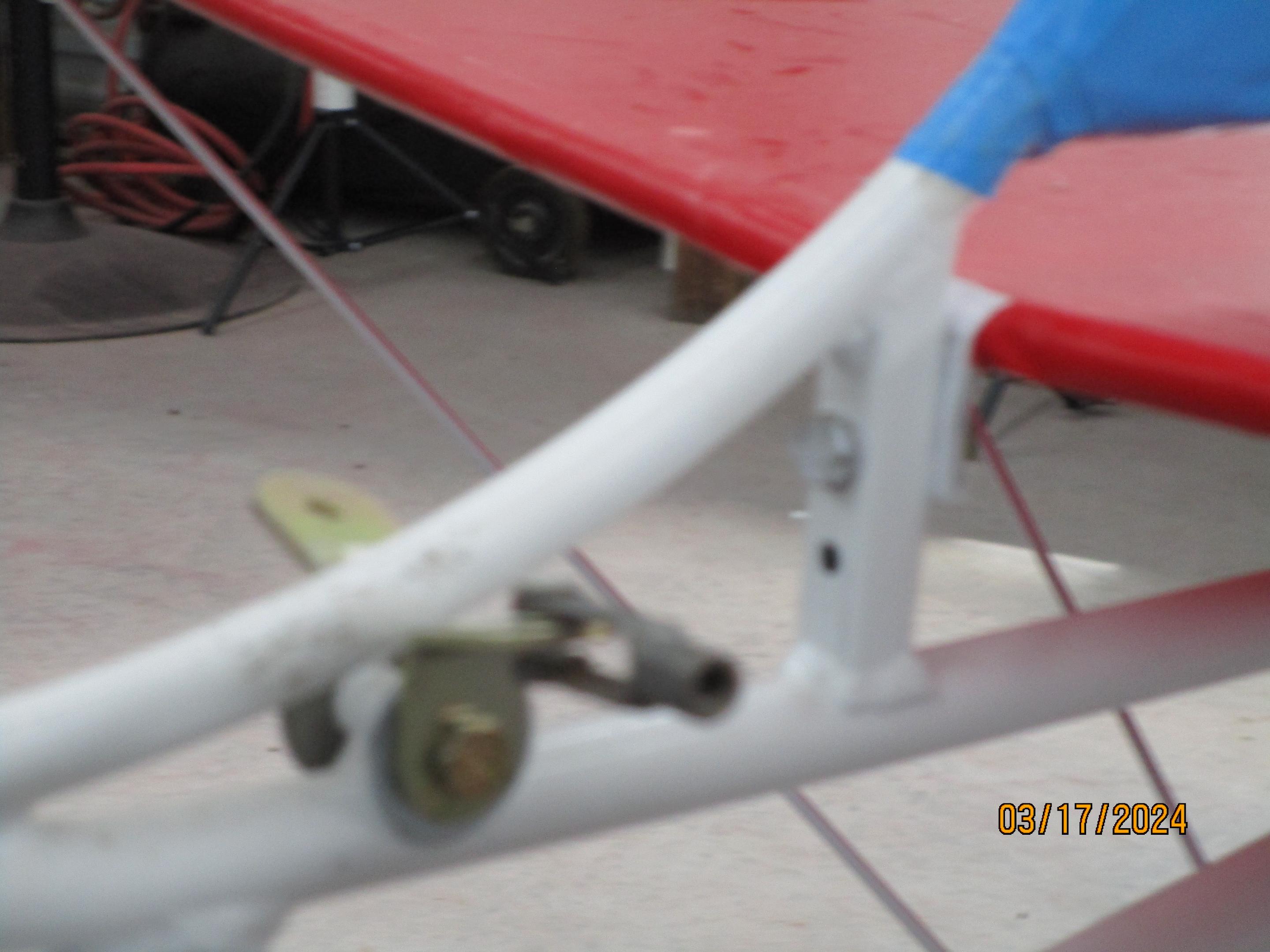

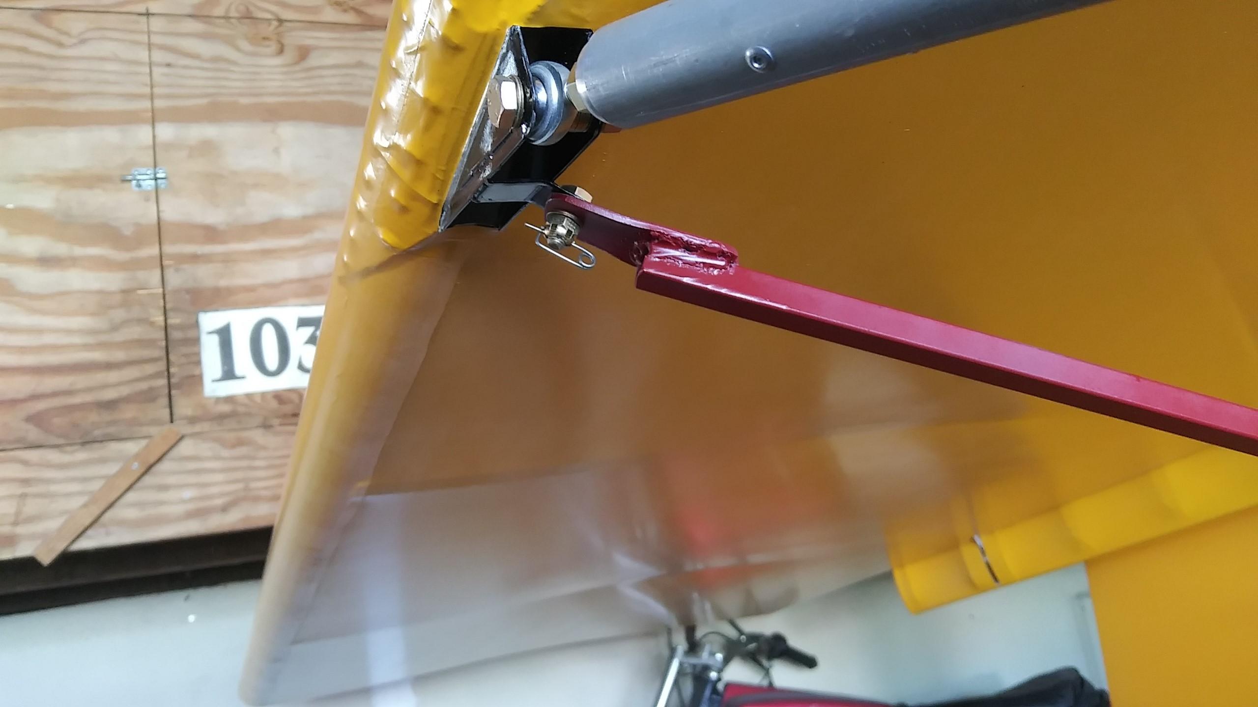

Waiting on two 3' 10-32 threaded rods. The "design" is now for a bent L-bracket drilled for 3/16" clevis fork at the rear spar tie-down (drilled 5/16" so I have a 5/16" od by 3/16" id bushing to make the attachment). At the 3/16" bushing welded to the base of the vertical stabilizer I have another L-bracket for another 3/16" clevis fork. The two will be attached by a 10-32 the threaded rod (for each wing).
Clevis fork mount at the rear spar tie-down fixture. I will bend the bracket when I get the threaded rod:
Clevis fork attachments at the vertical stabilizer ... I'll bend the bracket to position the fork/rod:
Here's the port wing root with the flapperon control cable grommet and the quick connect fitting for the pitot tubeing.

Kurt, I did something similar for the wing brackets, but non-adjustable...
I tack welded the flat brackets into place on the square tube, then bent them as needed to align with the tabs on the wings. (Note the ugly welds. These were some of the very first welds I did after buying my welder...)

The weather and my schedule finally coordinated enough for me to load the plane and test the tie down method. The wind was a bit heavier than I would have liked, but I went for it anyway.
This time I opted to try to load the main gear onto the trailer and then move one of the ramps to allow the tail wheel to roll up (versus just lifting the tail of the plane and pushing it all the way forward). The idea is to then be able to attach the rear stand while the tail wheel is near the top of the ramp and lift it directly onto the crossmember.
This would have worked, but I didn't have enough slack on the winch to bring the plane BACK a bit and set the stand down. And I couldn't go further forward either. I ended up holding up the tail of the plane until my wife came out to rescue me. She was pretty quick to respond to my calls and release the cable on the winch, but I still ended up with muscle aches the next day. I guess that was my workout for the day.
I've since made a mental note to not winch the plane up quite THAT far.
Once I had the tail settled onto the crossmember, I fitted the ratchet straps (eight of them) and snugged them down. It may be overkill, but I'd love a second opinion.
I was hoping to be able to tow the plane a little distance, but ran out of time, so I offloaded it and put everything away. But before I did that, I took it to the end of the driveway. I recently put a shorter (taller? - higher from the ground) trailer hitch on since the original was slamming the driveway thanks to the dip. It still taps the driveway, but much better than it was, and the plane sits nice and level.
Next step - hop on the surface roads and freeway and see how it does...
