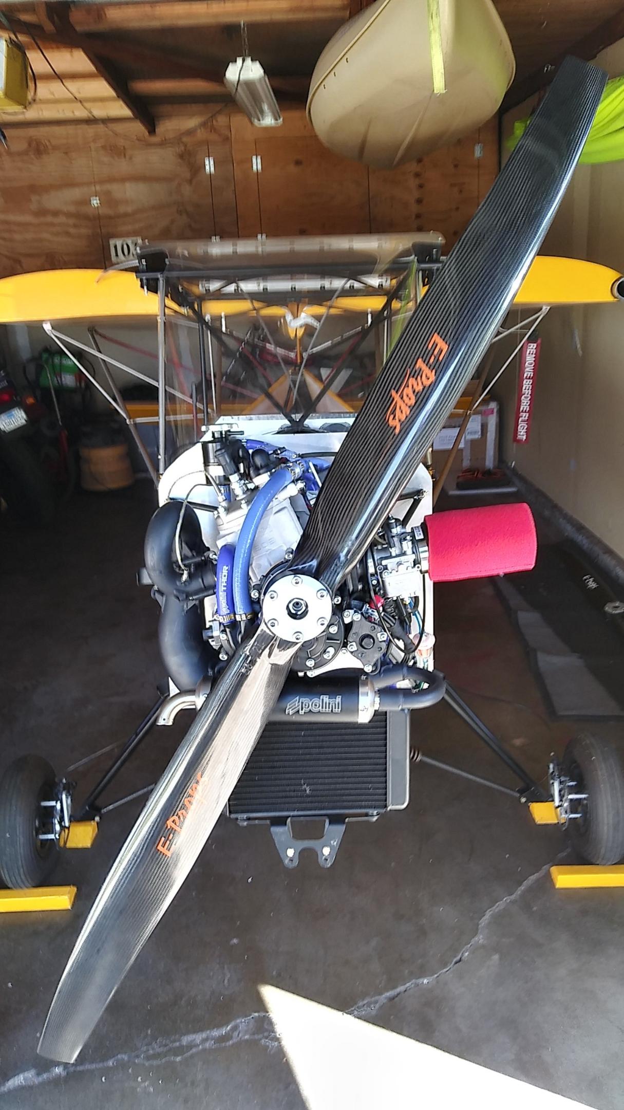

So today was finally the day that all of the pieces of my Polini 303 have been affixed to the aircraft. As of now I am just short some safety wire and coolant.

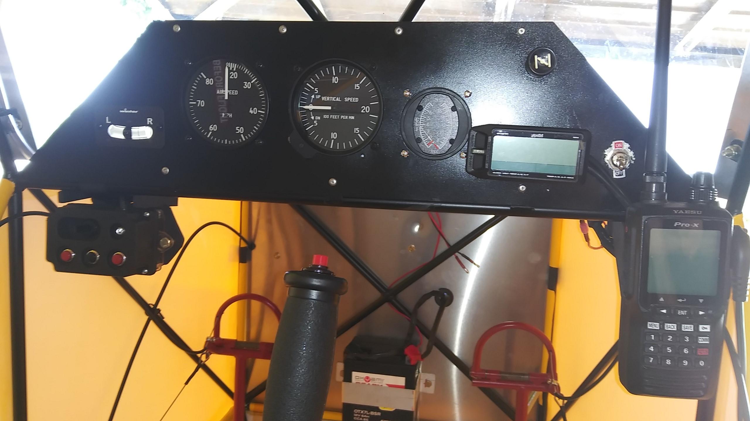

I also recently completed the bracket for the ignition switch (a rather large box for what it does, it seems). I spent some time determining exactly where to put it, but think I sorted it out nicely.
Having completed adding all necessary weight, I was ready to grab the scale and see where I ended up. To be honest, I was pretty nervous about going over. I had build "dummy" scales out of plywood to ensure that the height of each wheel was the same with the scale as without it. (By the way, I trust the scale; I used it to weigh my plane after it had been weighed by a professional aviation scale, and it was within a half pound.)
Total weight of the craft currently?
260
Now, I know you are thinking "that's over!" And it would be, if I didn't have roughly two gallons (conservative estimate) of fuel in the tank. I am also not accounting for the weight of the handheld radio nor the steel brackets holding the wings in place for transport. To be honest, I'm surprised that I am still under.
This poses another question, regarding the cowl (which I have not weighed nor attached). This sort of coincides with the Merlin Lite discussion from another thread, regarding the weight of the Merlin with the cowl pushing it over the 254 limit. It was mentioned that parts not necessary to fly the craft could be excluded from the final weight (I am paraphrasing here); things such as seat cushions, handheld radio, etc. Why couldn't the cowl fall under this category as well? And what exactly is the written rule on this (if any)?
A quick Google search yielded little in the way of results, and I figured it could make for an interesting discussion.

The Badland is flying without a cowl, so it is not necessary for weighing. Since it's water cooled, a cowl is not necessary for flying airflow. Good job on the weight! Seat cushions, radio, etc. is not necessary for flight. You will lose the 6 lbs or more. The FAA won't even take a second look at you. The fuel and radio will probably put you under the number. Expect to change the main jet, the factory said it's a 122 which might be a little rich. Most from what I understand are running a 118 or lower.
Re: Weighing in!
I haven't made time yet to sniff through part 103 to try to find the legalese, but it is my understanding that "not necessary for flight" is pretty broad. I can't understand why the cowl wouldn't be covered but a door or seat cushion is. That said, it may be the top speed that bites your butt.
260 is great, friggin good job!bOff the top of my head, gasoline weighs 5lbs a gallon, so two gallons would put you back at 250, plus the weight of the radio and your bracket. I'd say you made weight pretty easily.
Re: Weighing in!
None of the stuff I listed is necessary for flight or weighing. You made weight, with gas at 6 lbs per gal. NICE!
