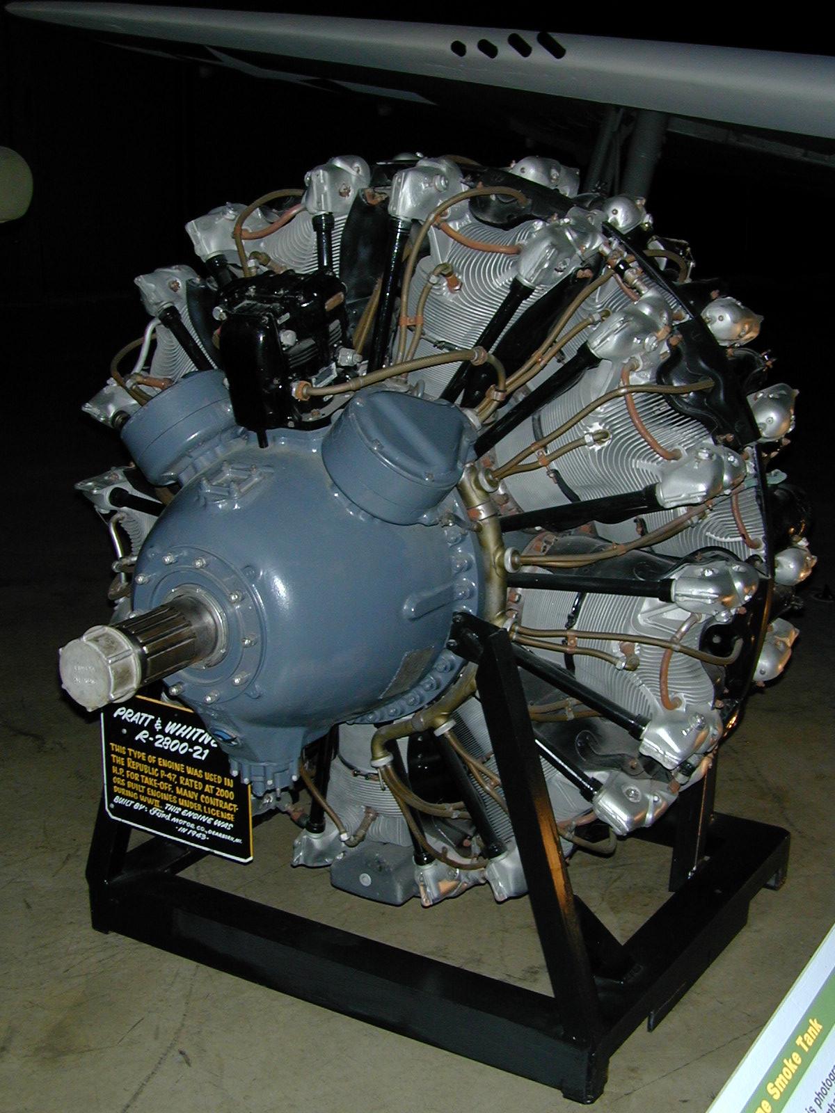

Ok, we're stuck here. Like I said, ALTERNATIVE ENGINES.
Oh gentlemen of the Wise Council, allow me to plead this case.
I present to you a link
Here are some photos for your review:
You can see the ancestry and thus the line of logic.
