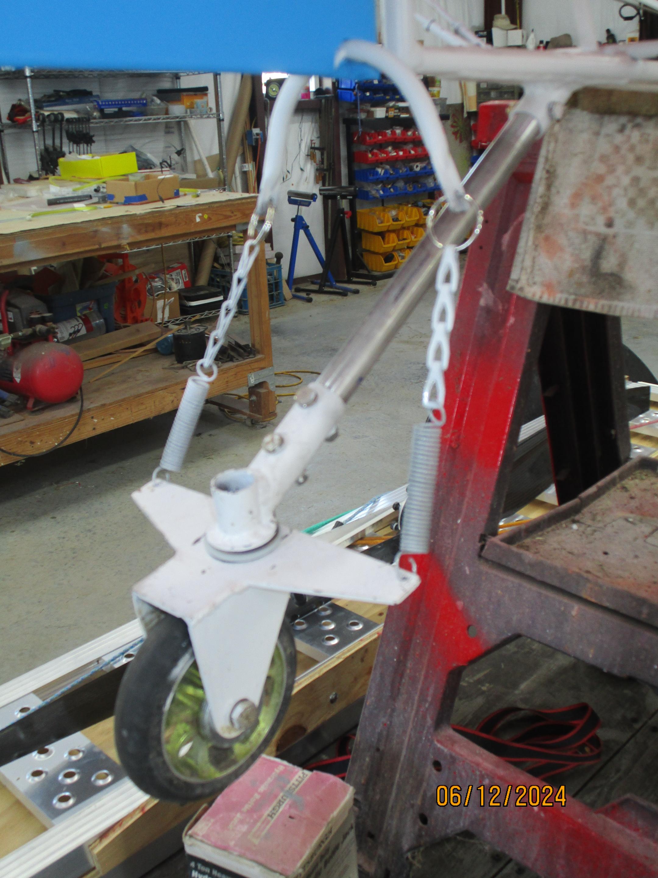

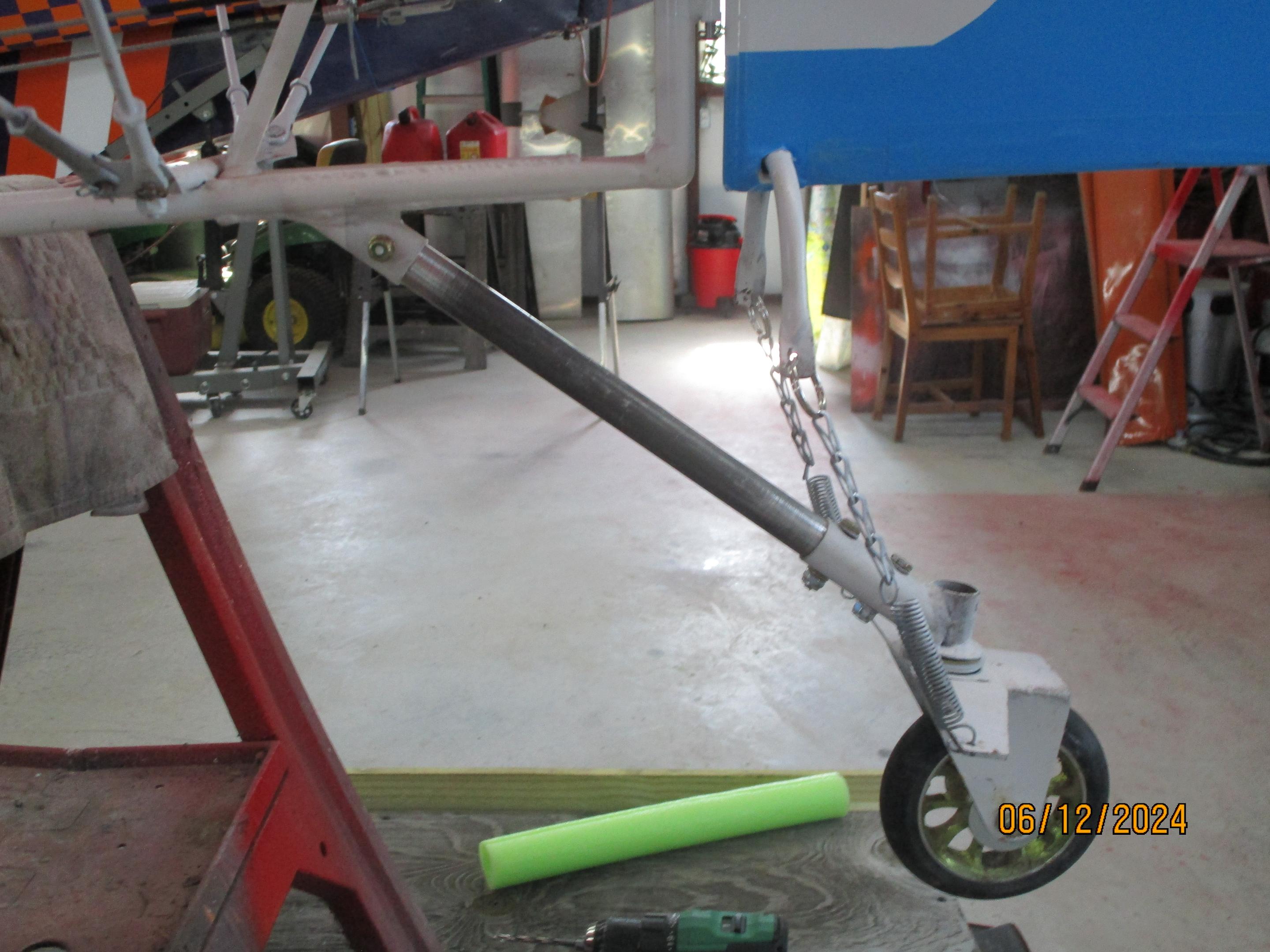

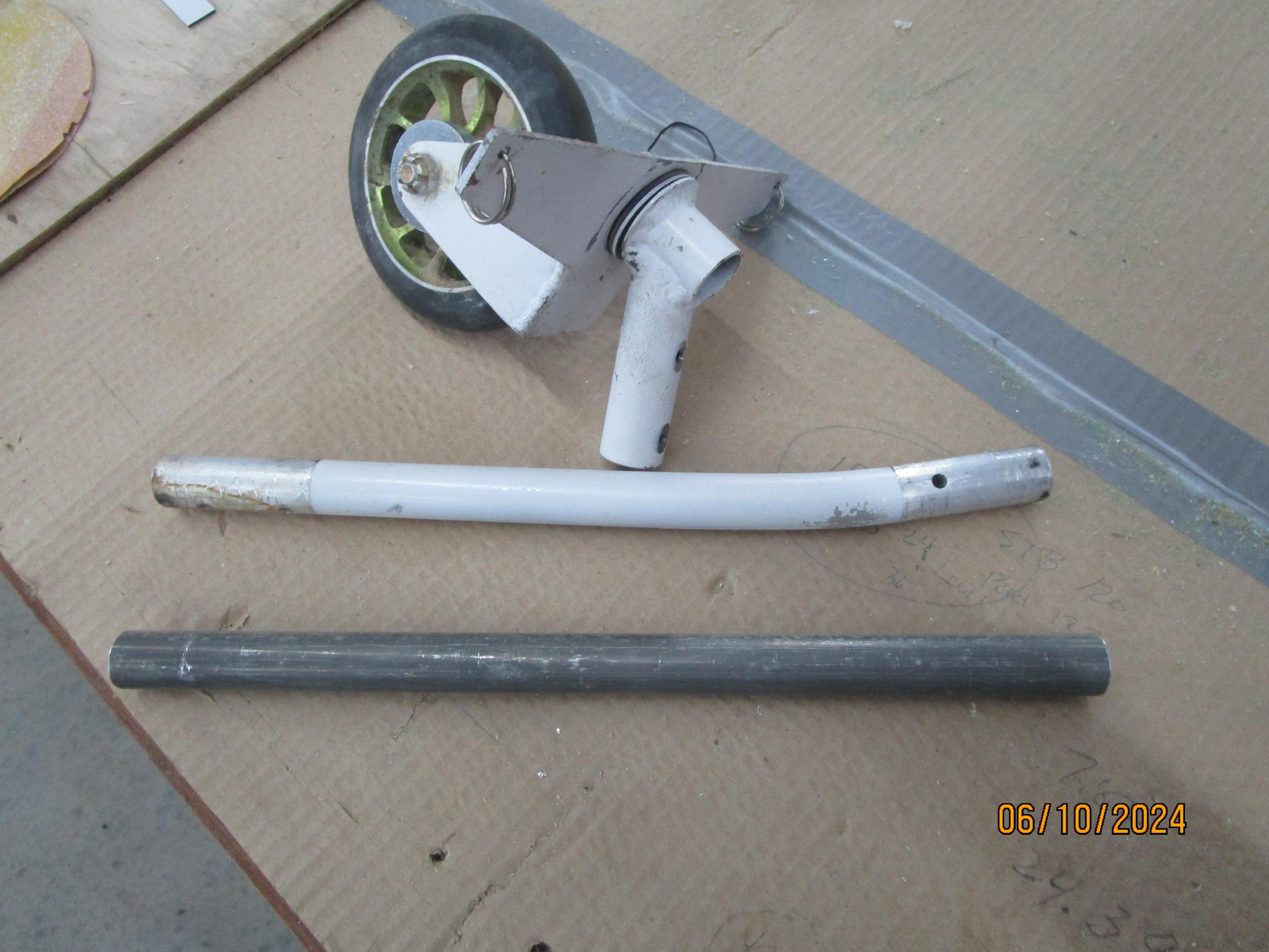

Checking over the rudder problem I found that the nicco press clamp on the cable at the pedal had not been properly swagged swagged. I replaced the sleeve and after swagging checked all of the other connectors. During this exercise, I noted that the tailwheel spring (a 0.75" diameter 6061T6 aluminum rod about a foot long) was slightly bent at the fuselage mount. I'm replacing it with the steel rod provided with the kit.

I have replaced the bent solid rod tailspring and the rudder springs coupling. After much thought, I believe the original rod bent when I had the tailwheel rigidly secured to the trailer bed and possibly hit pothole during transport.
The new springs on the steering horn finally match very closely.

Kurt, if possible, you should consider a pedestal for the aft end of the fuselage. You're not the first person to bend a tail spring as a result of having it strapped directly to the trailer. I've seen a few people use a flatbed trailer like yours but add a small footstool under the tail to elevate the tailwheel.
Re: Updates before 3rd round of taxi testing
That was in the original design using PVC pipe. Back to the drawing board. I'll probably hinge it to the floor
