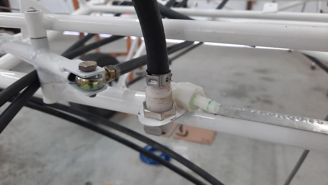

(1) Started routing the fuel line. I added a T-fitting from the bottom of the tank so that I could add a quick release/cutoff drain connector. The other path is naturally to the engine. I'm routing under the seat and off to the port-side around the flap actuator. I plan to add the primer bulb and cutoff valve near the throttle lever and will probably place the fuel filter on the engine side of the firewall.
Fuel Drain Quick Release fitting
