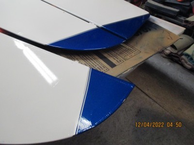

I use automotive pinstripes to cover the paint line between two different colors. Or a decal/sign shop can make them in whatever width you need or want.

Now THOSE are pretty!
Re: Threaded Oratex
Very sharp! What's your consultation fee?
