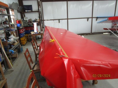

Crazy weather in North Texas ... yesterday no higher than 42 degrees in the shop ... no work done. Today's high is projected at 73 degrees and at 8 this morning it was already near 60 so a 15 minute run of the propane heater had the temp comfortable enough to glue the port topside panel in place.
I need to complete the covering of the tip and root ribs before using the Fixing tape to layout the demarcation glue lines for covering the leading edge with the Sky Blue. Once that is done I can apply the adhesive; glue the leading edge wrap in place; shrink; and apply the white finishing tape trim.
Getting close.
Port wing topside panel in place
