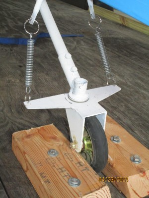

I believe i finally have a good set of springs. Relaxed, they are about 2.5" + 3/8" for the mounting ring. Diameter is about 0.5".
Will try mounting later today.

Hey Kurt. There are several free online services for converting video formats. If you don't wish to use them, if we can find out how to transfer the .mov files, I have the applications to convert them for you. However, I don't know how Apple downloads from the iCloud works, sorry. I'm an Android user.ksatter26 wrote: ↑Mon Apr 22, 2024 3:38 pm I believe i finally have a good set of springs. Relaxed, they are about 2.5" + 3/8" for the mounting ring. Diameter is about 0.5".

Those should work for you Kurt. Are they pretty stiff?
Funny thing, I was just checking the tension on my springs...I am having the same issue you are when backing the plane off the trailer. I may go a notch tighter on mine.

They are pretty stiff, but if you look closely the two do not match. I guess I didn't check them when I pulled the pair out of the "spring bin" at the hardware store. I'll remedy that tomorrow, but it looks like they'll work fine.
Reset and tightened the brake and rudder cables and am currently working on the folded wing stays. Once done I hope to get back to the airstrip for testing ... weather permitting. It has been very windy. I still have to look at the CHT and EGT probes. I hope it is only connections, but I saw no movement of the gauge on the brief taxi run last week.
I have a "game scale" that I'm going to try and attach to the tailwheel bracket and to the car tow hitch. The plan is to run the Polini up to max power to get a rough reading on the thrust.

Well, the springs look to be the same length. As long as they have the same spring rate they should be fine, at least for now.
