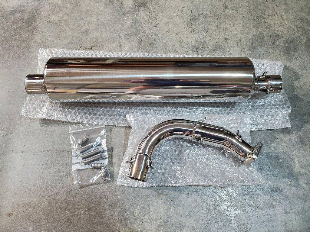

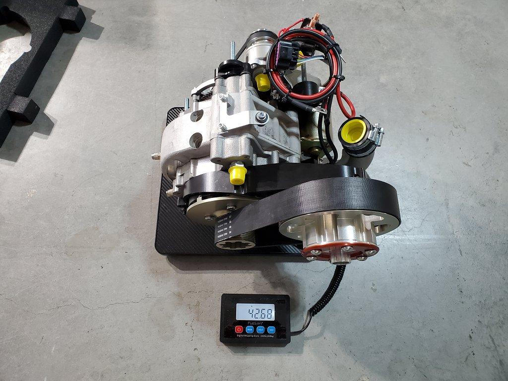

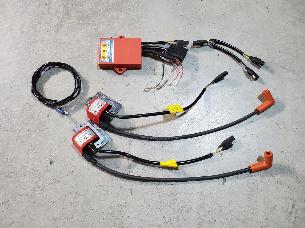

I have a quote for the F23 from Feb 2023. For the engine, basic exhaust, belt drive, and shipping, the carb version was $11,172.69 and the FI version was $13,485.97. Used F23s can be had in the $5k-7k range though.Badland-F5 Pilot wrote: ↑Tue May 07, 2024 5:28 pm
The F23 from Hirth runs in the $7,000 to $9,000 range (OUCH!) based on options like fuel injection, oil injection...etc. The big advantage to it is you'll most likly never have to rebuild the engine. It has a 1,000 hour TBO!
Nice engine though (for a 2-stroke). The weight is going to probably be too high for anything but the titanium frame.

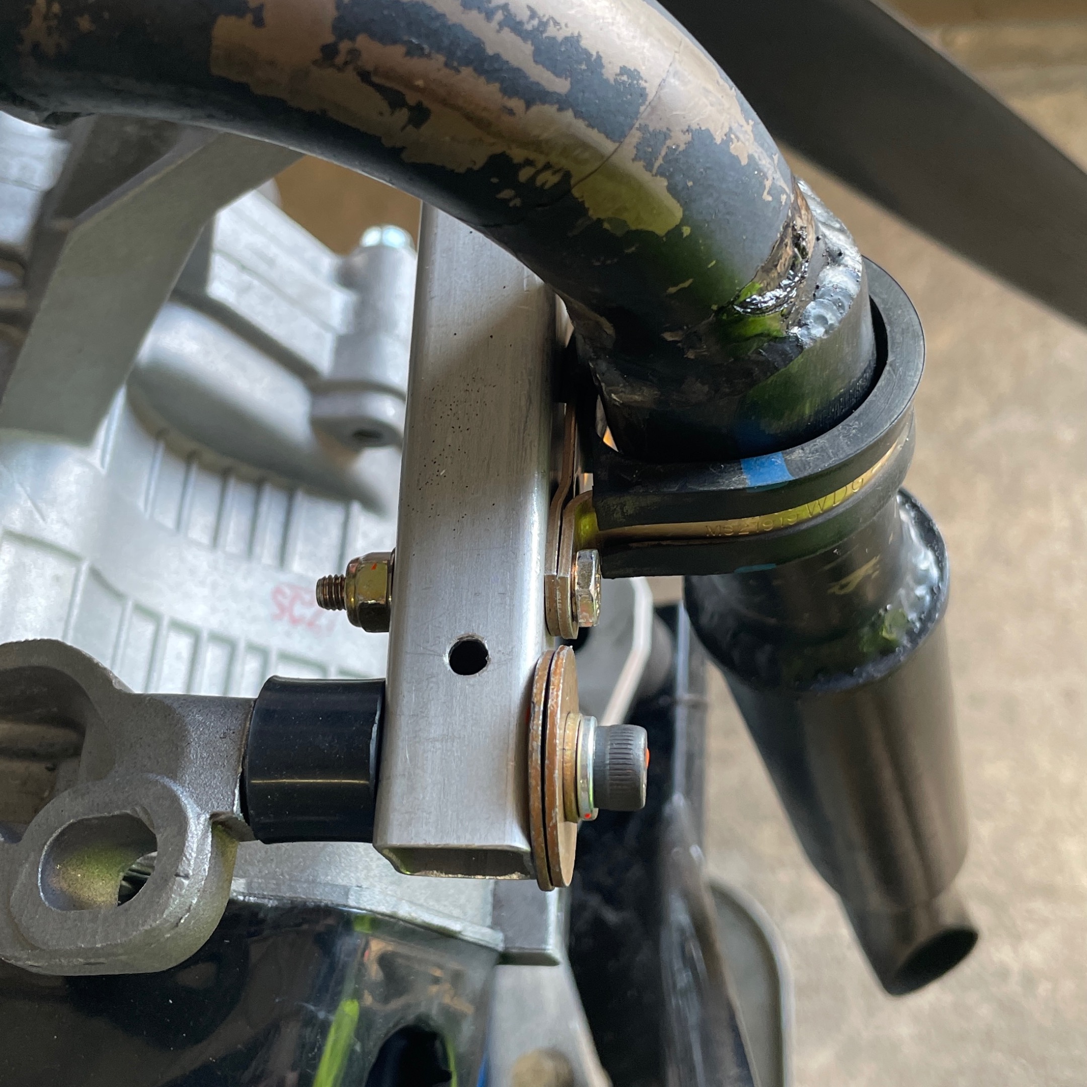

So far the only problem has been the bracket that holds the exhaust pipe on the right side. I am on the third iteration of it but this seems to be holding. There is a lot of vibration it has to hold up to on the ground, in flight it is much smoother. A pair of lord mount like vibration isolators between the engine and bracket is doing it.Badland-F5 Pilot wrote: ↑Mon Jun 24, 2024 5:53 pm Thanks Tom for posting. I'm really liking that engine, but of course you're already flying with it Have you run into any issues or surprises with it?

I’m at sea level and I’m guessing 500fpm, climb at 50 at 5600rpm to get away from the airport, cruise about 55 at 5000 rpm.13brv3 wrote: ↑Tue Jun 25, 2024 7:47 am Sounds good. What climb rates are you getting? Climb and Cruise RPM?
I've got a Briggs Vanguard 38 (627cc) v-twin on the test stand now and it's doing well. At 75 lbs I'm getting 38HP at 5500 using a test club. This engine definitely needs to find a plane, but my eventual Badland will almost certainly be getting the AIXRO XP-40 engine.

Excellent, thanks for the info. I'll have to watch how I mount that exhaust. Is there the possibility of using the flexible exhaust coupler like this-fly44d wrote: ↑Tue Jun 25, 2024 4:36 pmSo far the only problem has been the bracket that holds the exhaust pipe on the right side. I am on the third iteration of it but this seems to be holding. There is a lot of vibration it has to hold up to on the ground, in flight it is much smoother. A pair of lord mount like vibration isolators between the engine and bracket is doing it.Badland-F5 Pilot wrote: ↑Mon Jun 24, 2024 5:53 pm Thanks Tom for posting. I'm really liking that engine, but of course you're already flying with it Have you run into any issues or surprises with it?
https://www.amazon.com/Autarboor-Exhaus ... rce=1&th=1
? or not a good idea because of weight?

UPS brought me a couple of boxes today. I did some quick weighing and came up with 61.5 lbs for everything except coolant. I won't likely do anything with it for some time, since I have other projects ongoing, and the kit won't be here for a long time.
Re: 4-stroke engine options?
This is the AIXRO HP-40, yes? Very cool.
So, what is the expected benefit of this over a piston engine? (I don't know much about Wankel engines.) Right off the bat, it seems pretty light, comparatively (or am I mistaken?).
I love rotary engines, so that's a big part of the benefit to me. I've owned a couple RX-7s, and put a Mazda rotary in an RV-3B. The engine should be very smooth, and lighter than a normal 4-stroke making similar power. I'm all about making legal weight, so being light weight and not 2-stroke is a requirement. It's a MUCH less known option of course, but I never seem to use the correct engine in anything, including my current 912 powered Onex.
