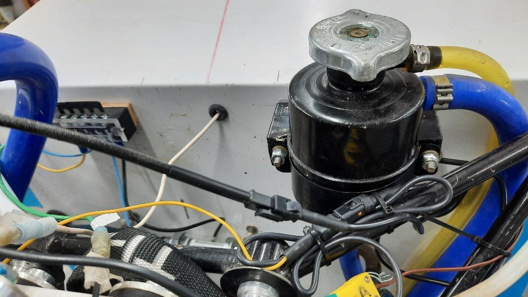

After finally getting my cooling system temperature sensor and gauge working and some discussions with my 303 Guru (London Ivey in Tampa) we determined that the location of the reservoir (positioned BELOW the highest point in the cooling system, ie., the elbow off the top of the cylinder head) was not proper. The reservoir needs to be above the highest point. I originally located the reservoir on the port side too low as can be seen here:

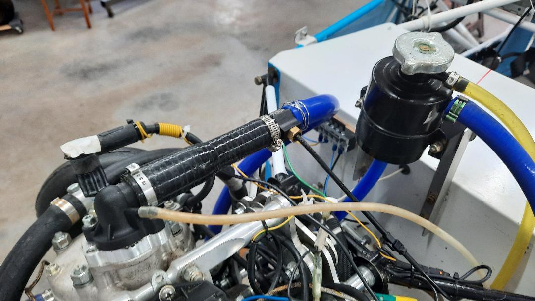

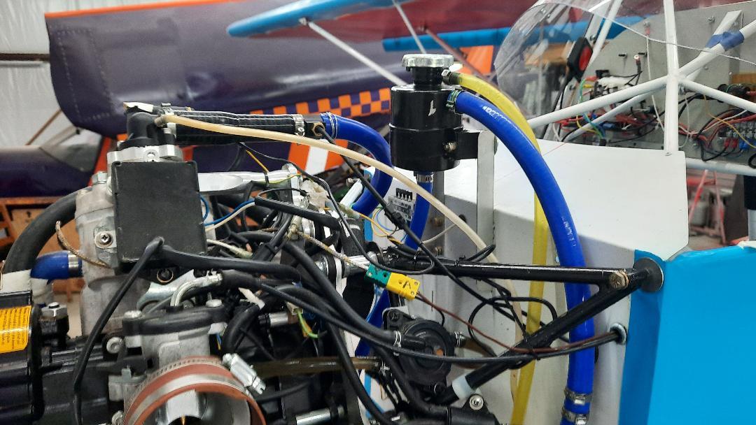

I made quite a few measurements and determined that I would be able to move the reservoir to the center of the firewall by fabricating a mount (from 0.75" L-angle stock). The new position and mount allows me to move the fill hose outlet ABOVE the cylinder head hose (up approximately 4") and STILL reside UNDER the nice bubble cowling. As before, I still need to remove the cowling to add fluid.
I was able to run the engine for a bit and noted that the coolant temperature sensor/gauge is working (finally). Earlier I installed a bleeder valve in the system and will bleed the system to get out any air in the lines.
