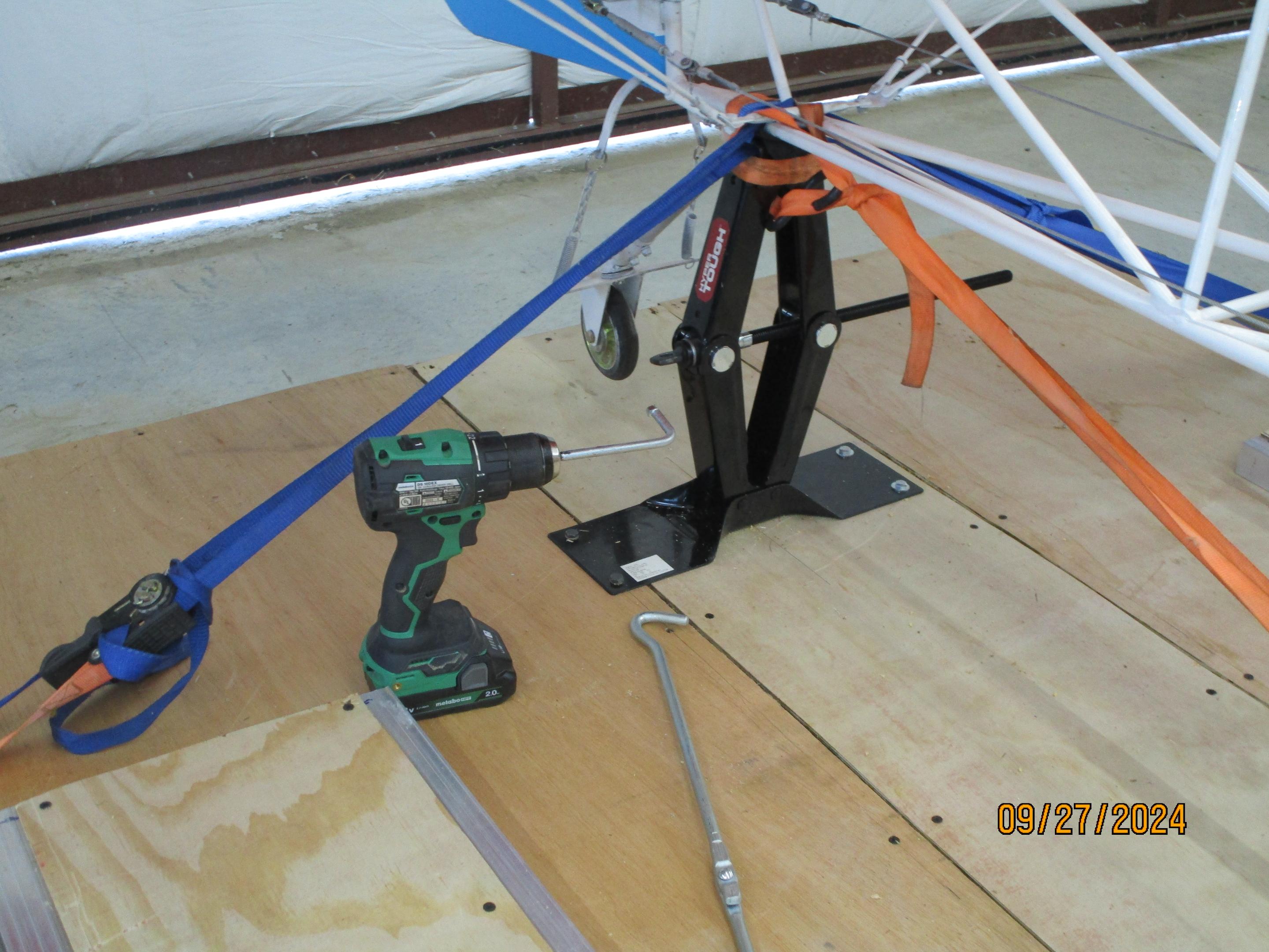

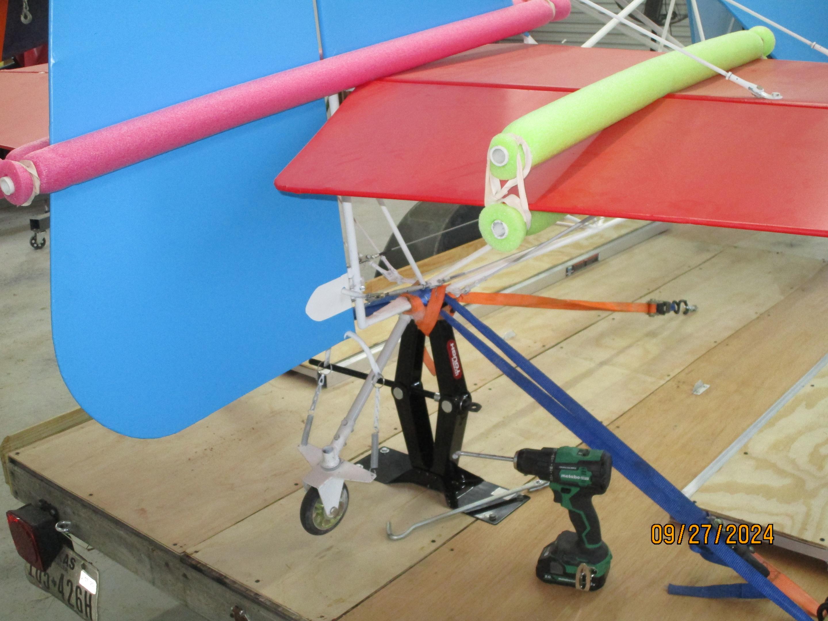

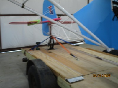

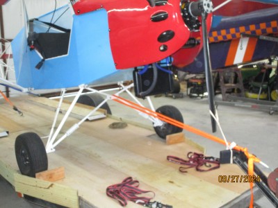

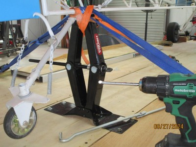

With my grandson off the A&M and my buddy deep into his Miata electric conversion, I thought I'd try unloading and loading the beast from/to the trailer by myself. While I found it technically possible with the shopstand aft fuselage support in place, I found it to be difficult and tiring lifting the tail up enough (with the wings folded) to fold down the shopstand to roll the beast off the trailer. I thought about it and decided I'd give Peer's automotive scissors jack method a try. A Walmart special at ~$23 (15500 lb capacity) and I set to work. I finished the install yesterday and it looks good.
The jack came with a long bent rod to turn the screw raising and lowering the jack. It takes a lot of turning to traverse the 15" height, so I bent a long 1/4" bolt which I insert into my battery hand-drill to raise/lower the support much quicker.

Looking good! That scissor jack is the way to go, I think. I have no desire to lift the tail of my plane, as I am still recovering from the injury from the last time.
