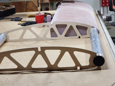

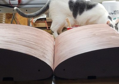

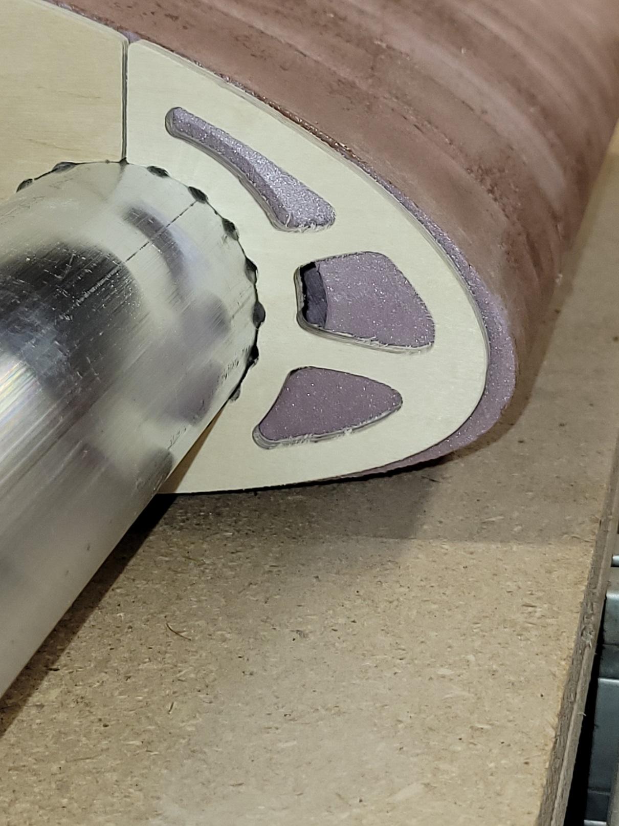

Here are some small sections of wing I'm building to show the difference between the normal wing profile vs the exact Riblett airfoil.
The small leading edge protrusion shown above adds support behind the fiberglass skins that will be formed from the molds shown later.
The standard wing might also benefit from a formed leading edge that wraps directly against the tube. I'm building a model of each so I can see how they each work out. Once I decide which way to go for sure, I'll build the full span wings.

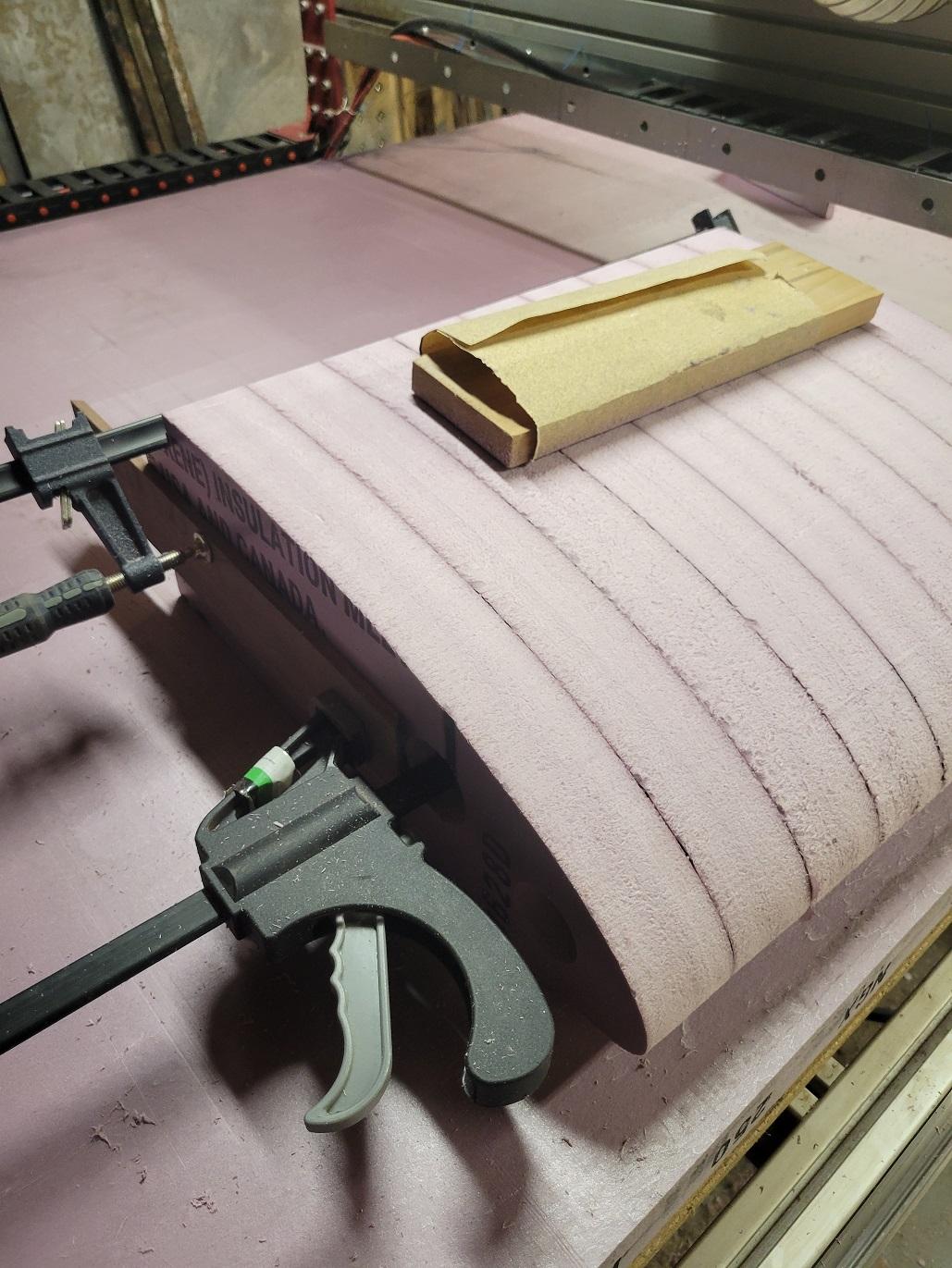

These sheets of Baltic Birch plywood aren't exactly cheap, but I can burn through a few iterations of the ribs until I get the details just right. Unfortunately, I got a little overzealous and cut out enough to do a whole wing set before I remembered that this is supposed to be a small proof-of-concept first. I might have just made a bunch of kindling, or I might be prepared for the full build. It depends on if I like the results of my test pieces.
I'm not really happy with the way these pack together. Getting these foam blocks perfectly aligned and held in place while the epoxy sets up is a bit more challenging than I expected.
I did eventually get them "close enough" and sanded them to blend the minor imperfections. Once I skinned the whole thing with a thin coat of lightweight filler (aka: microballoons), final sanding and blending becomes a lot easier. These molds are the first step in creating the final leading edge skins. Once these are perfectly smooth and glossy, I will cast a fiberglass mold of these blocks that will become the female mold that casts the leading edge sheets. It's a copy of a copy process, but apparently that's the normal way fiberglass parts are created so I'm elbows-deep into learning this whole method of producing parts.

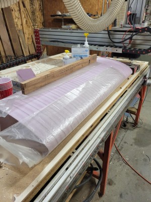

I made a little more progress on my leading edge molds tonight. I figured out a better way to cut out the pink foam for stacking so they hold themselves perfectly aligned. By cutting 4 holes with 2 of them slightly bigger than the others, I can pull the plug from the bigger holes and slip them into the smaller holes to act as alignment dowels. I sized them to have about 0.008 inches interference so they press in with some friction. These stacks got glazed like the originals and tomorrow I'll glue them together to make solid 54-inch molds that will get just a bit more sanding and final shaping before I use them to create the female molds that will then create the final products. I decided to go with 54 inches so there's plenty of trim on the ends to make each panel span across 2 bays of the wing with the seams landing centered on a rib.

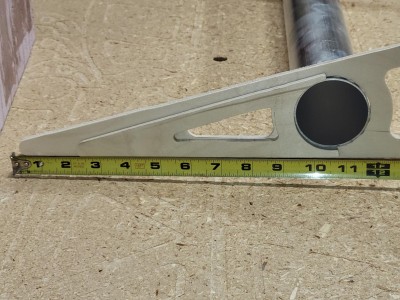

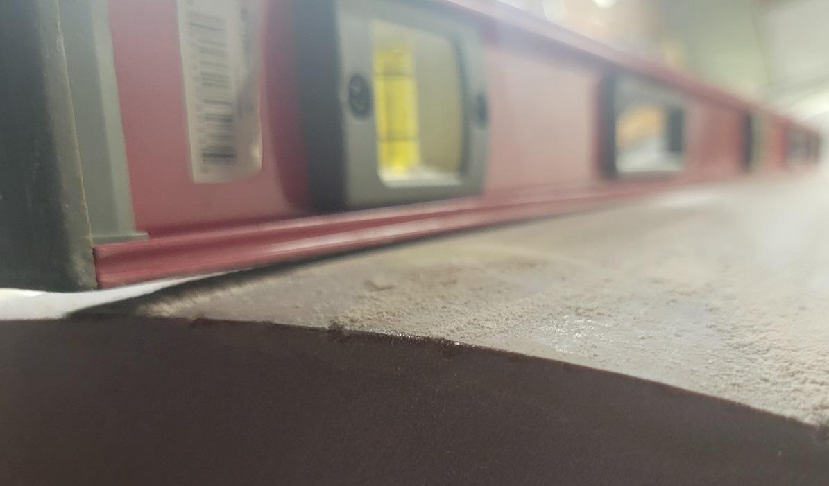

After doing some initial dry-fitting, it looks like I may have made a bunch of expensive kindling. I am still planning to make the test pieces just to get real test data, but I'm seeing a few "opportunities for improvement" in the fitting and alignments. I could probably make it work as-is, but I want the finished product to be better.
Here's my photo dump from the night. Notice on the smaller wing profile how much leading edge shape is missing when the front spar is used as the leading edge. I know the wing still flies just fine, but Harry Riblett was famously quoted as saying the first 10% of the airfoil shape is the most critical. I think that alone is worth doing the fiberglass leading edge cuff, even if you only used the first 5 inches of it. Also notice how easily the fiberglass will lay across the spar where it can be bonded to the spar for a little extra stiffness.
This shows setting the test panel in front of the foam molds to get an idea of the wrap onto the spar and ribs.
The large panel fitment is where the problems show up. With this much hanging out the front, it's really easy to misjudge how far back it should be stretched. I can see accidentally making the wing a half inch wider or narrower by simply pressing back a little bit on the cuff while setting it up. For this reason, I believe the little rib extension on the front of the spar is going to be critical for positioning the cuff properly.
Setting the small and large ribs together shows that I may have miscalculated how far forward to slide the center of the wing. My previous comment about moving the center of lift forward might be just barely true with this much tail sticking out the back. If I re-cut the large ribs, I'll probably move the whole rib forward about 1.2 inches, which will make that leading edge rib segment even more critical.
It seems almost comical to use a tape measure to show dimensions that were cut with precision less than .005 inches, but this gets the idea across.

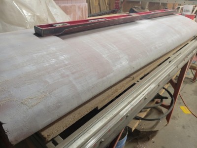

I managed to get both of my leading edge molds all lined up and bonded together. There is about a 1/16 inch variation over the length of the structure that I'm trying to work out. I won't be happy unless it's really, REALLY precise when the final casting comes out. I'm also starting work on setting up a wing testing jig so we can have dependable test data from the load tests.

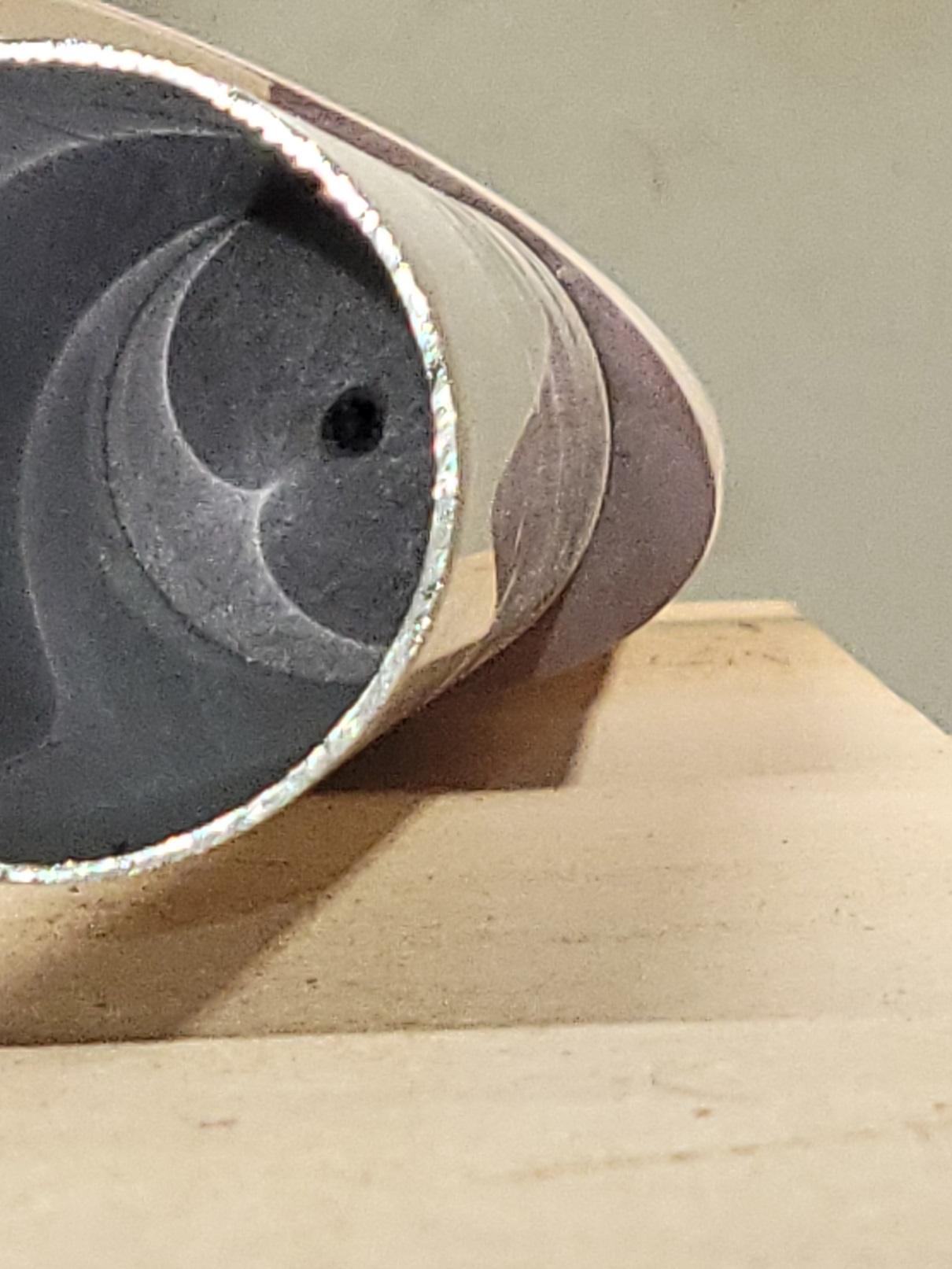

My perfectionism is starting to catch up. Or, is that properly called "ADHD Hyperfocus"? Anyway, I feel like zero progress was made because these still aren't perfectly straight and smooth. I think I'm going to glue some 120 grit sand paper to the edge of a 4-foot level and use that to knock down the high spots.

I just watched the Trent Palmer video. He was trying to add extra cuff to stretch the chord and in doing so he created a new flatter airfoil shape. The new shape was not a carefully engineered airfoil like the original Riblett, but was something that has a lower chance of performing well in the intended application. His flight testing proved that to be true. That's significantly different from what I'm attempting.
I want the shape to be EXACTLY what Harry designed so the airfoil works the best it can. Both my small and large wings will be the precise shape, just stretched to a slightly longer chord. That extra chord is properly matched with extra thickness to maintain the thickness ratio.
My working theory is the best way to get the whole airfoil to the correct shape is to eliminate the scallops between the ribs. My method for accomplishing that is a very thin, lightweight fiberglass sheet that spans the gaps between ribs and supports the fabric.

I managed to get some more sanding/shaping done on my fiberglass mold and it turns out I wasn't quite as close to good as I thought. Holding sandpaper under a 4-foot level is working really well for getting the waves out, but it's also showing just how poorly I had those foam blocks aligned when I glued them. I don't think pink insulation foam is the best way to do this. I'll give it a few more days to see if I can save it, but I'm also considering other ways I can use the CNC to start over and make it better. Structural foam carving may end up being a better choice since it machines beautifully and has far better compressive strength. I just wish it wasn't so dang expensive!
Re: Build Log: MrPilotRon
Maybe the picture don't tell the full story, because they look pretty straight to me.
Is the issue only at the tip? And is there a light compound you could potentially use to fill those gaps?

Mostly I'm just being a perfectionist and it probably doesn't matter. I've got it within about .050 of an inch everywhere and within .020 on 98% of it. I am going to smear one last layer of "peanut butter" mix over it with a full-length straight edge squeegee and then call it good enough. That should have the whole thing within .015 of being perfectly consistent.

Posts: 823
mrpilotron wrote: Mon Nov 25, 2024 10:38 pm Mostly I'm just being a perfectionist and it probably doesn't matter. I've got it within about .050 of an inch everywhere and within .020 on 98% of it. I am going to smear one last layer of "peanut butter" mix over it with a full-length straight edge squeegee and then call it good enough. That should have the whole thing within .015 of being perfectly consistent.
Unfortunately, I'm sporting some new hardware for a little while and She Who Must Be Obeyed has declared the workshop off limits...
I know that feeling....I used to be in "but I can make it a little bit better" mode all the time. It's taken many many years for me to back off, and realize there is a point of "it's good enough". Though, with being an efficiency nut, it's going to be difficult to allow some things to be just "good enough" when I start building. The problem is, if I don't, then the project is likely never going to be completed.
And at .015, that's pretty dang good and well into the "good enough" territory.
Ouch on the new hardware. I hope it heals quickly.
Thanks again for posting your work. It really is looking pretty awesome.

Posts: 823
mrpilotron wrote: Thu Oct 31, 2024 2:16 am Here are some small sections of wing I'm building to show the difference between the normal wing profile vs the exact Riblett airfoil.
